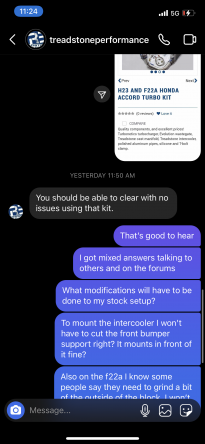

    Ive asked treadstone direct on Instagram and their answer so far is unclear as well.

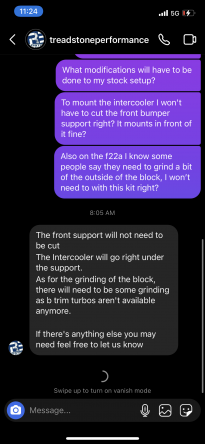

        I spoke to treadstone and finally got a reply and they said it should clear. But from the replies here it seems you guys are saying no still.
        They did confirm part of the head will need to be grinded to clear however. Think right now the dsm route is looking best still
