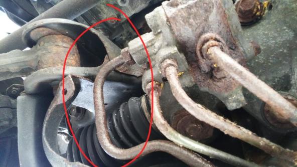

    Which line is the one circled in red?It was rusty and had a pinhole that leaked so I wrapped it with teflon and some electrical tape. Is it fine our should I replace it? Since putting in the tape it hasn’t leaked.
    Hope this helps. It's a low pressure return line back to the cooler / reservoir. If it's not leaking don't worry about it.

      Sadly it started leaking again and i can feel the car losing fluid in the system. How should i go about replacing the line?
        If the hose is rusty, you’ll have to remove the hose and have a shop braze in a new section and fitting.

          Yep. Or find a similar length with proper ends and bend it the same way to fit. I believe this is just brake line. Or make your own line with fittings and a bender tool + end making tool. (Can't remember the name). I have all these tools to do this.
