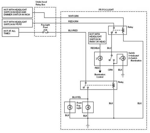

                  for those interested, i found the OEM wiring diagram for an 03 accord. it is very similar to my design however it implements the highbeam cutoff. this means that when the highbeams are triggered, the foglights will turn off. this wiring diagram also only allows the foglights to be on only with the headlights and not with the parking lights like in my design. this is just for the sake of options when wiring the foglights.
                  here is mine.
                  and here is the OEM wiring diagram for an 03 accord

                    it makes me so happy seeing other people who can read schematics. timmy, youre my hero, wiring is like half of working on a car, yet its something most people have a problem with.

                        it helps to read schematics when you've just graduated with a B.S. in electrical engineering. i love wiring stuff up. wiring is very basic, people just need to take the time to learn.
