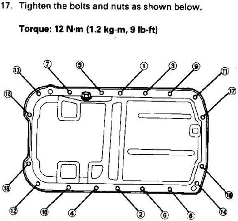

Now that all that crap is out of the way you can drop the pan, scrape, pull, and tear the old gasket out. Clean up (mostly so you can see the new leaks when you tighten the new gasket down to far) and then put the new gasket on, replace the pan, dust cover, small crossbar, engine crossbar, and tail pipe. Clean off the WD-40 and you should be good to go.
