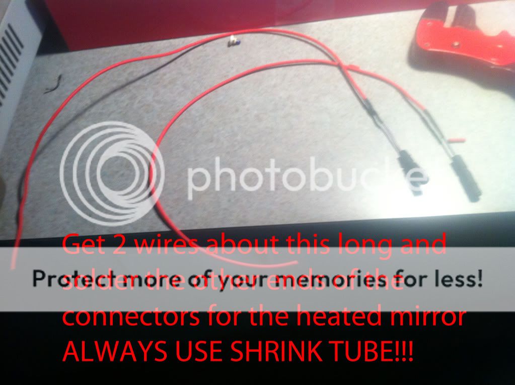

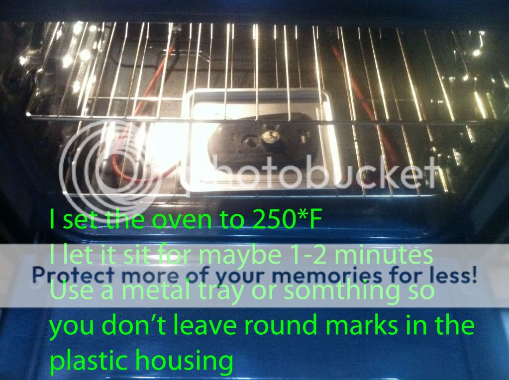

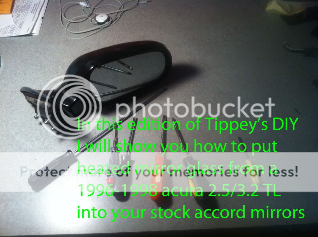

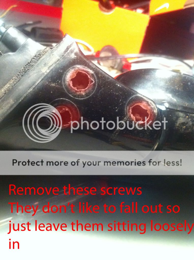

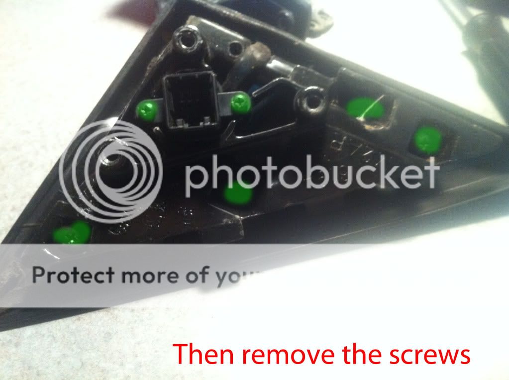

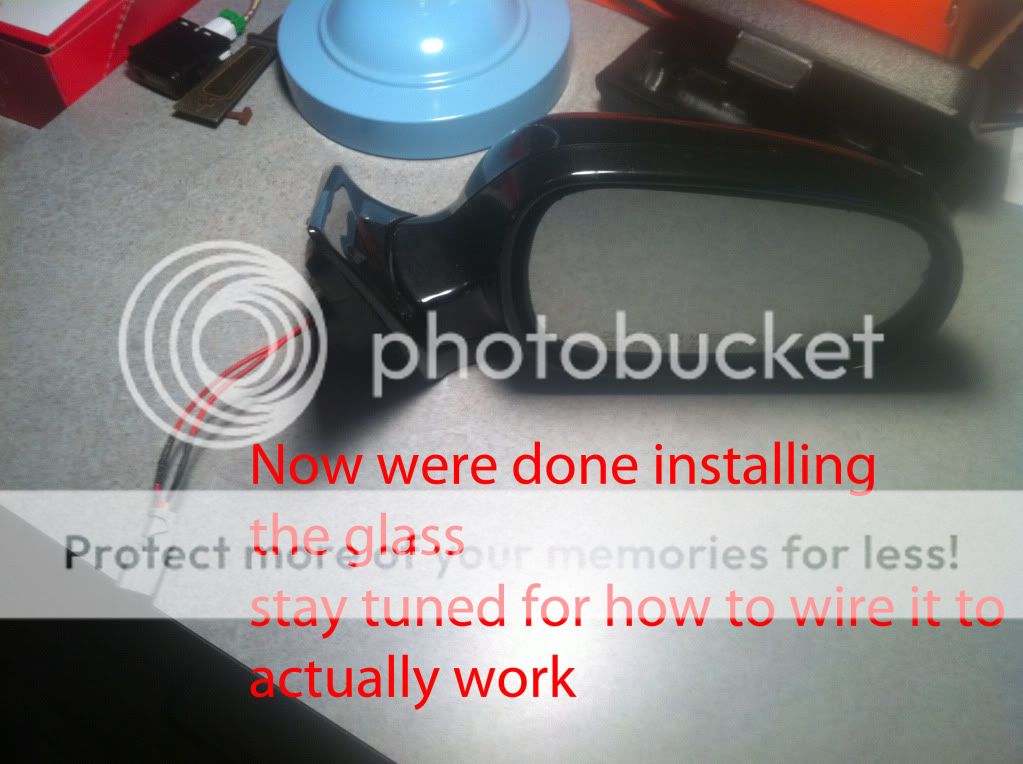

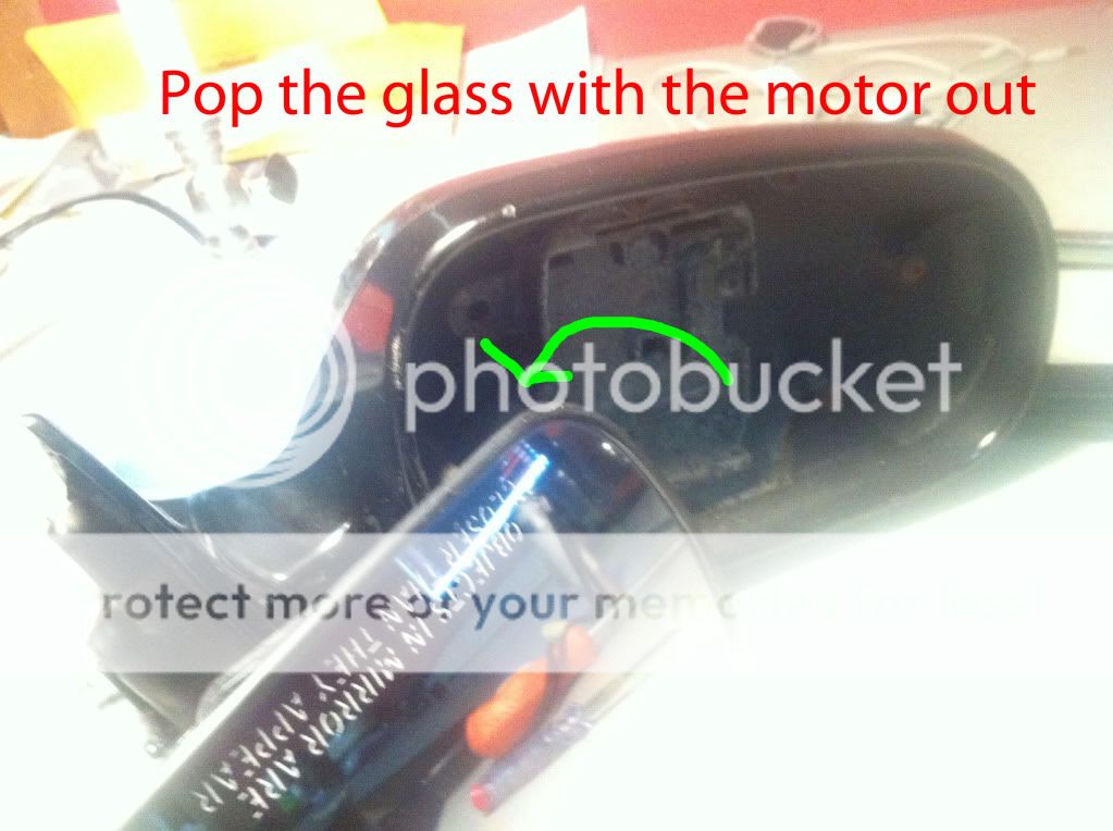

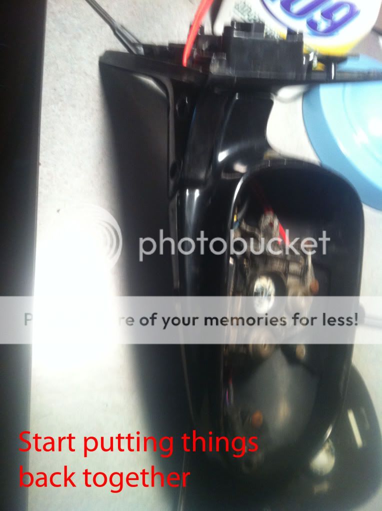

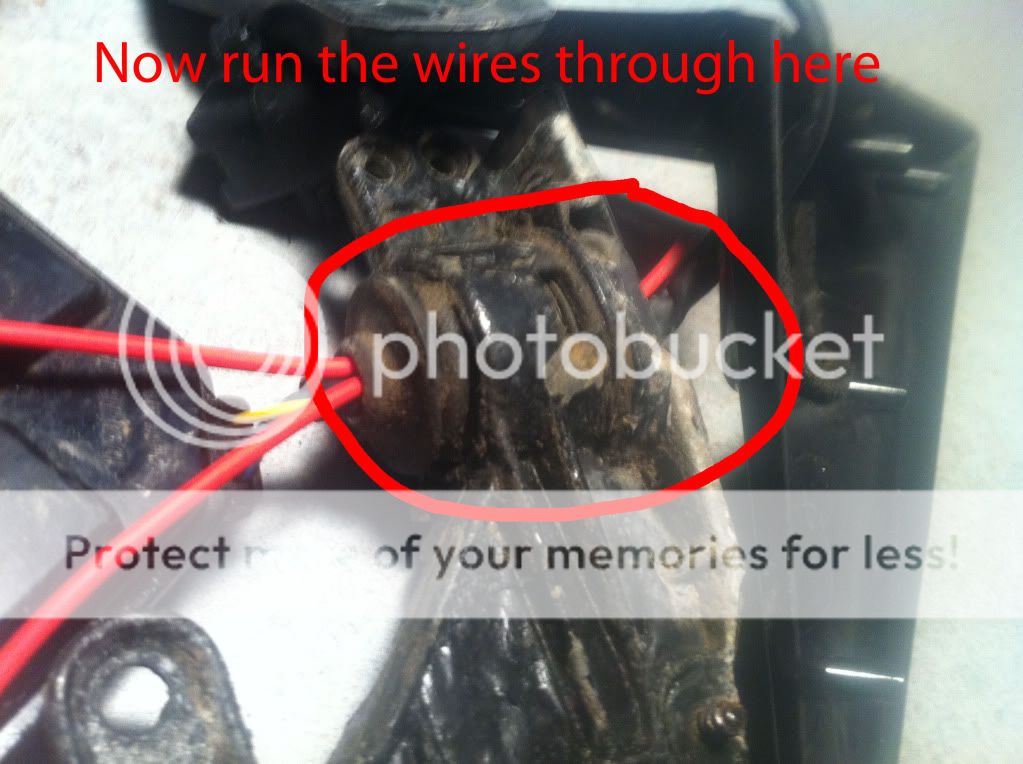

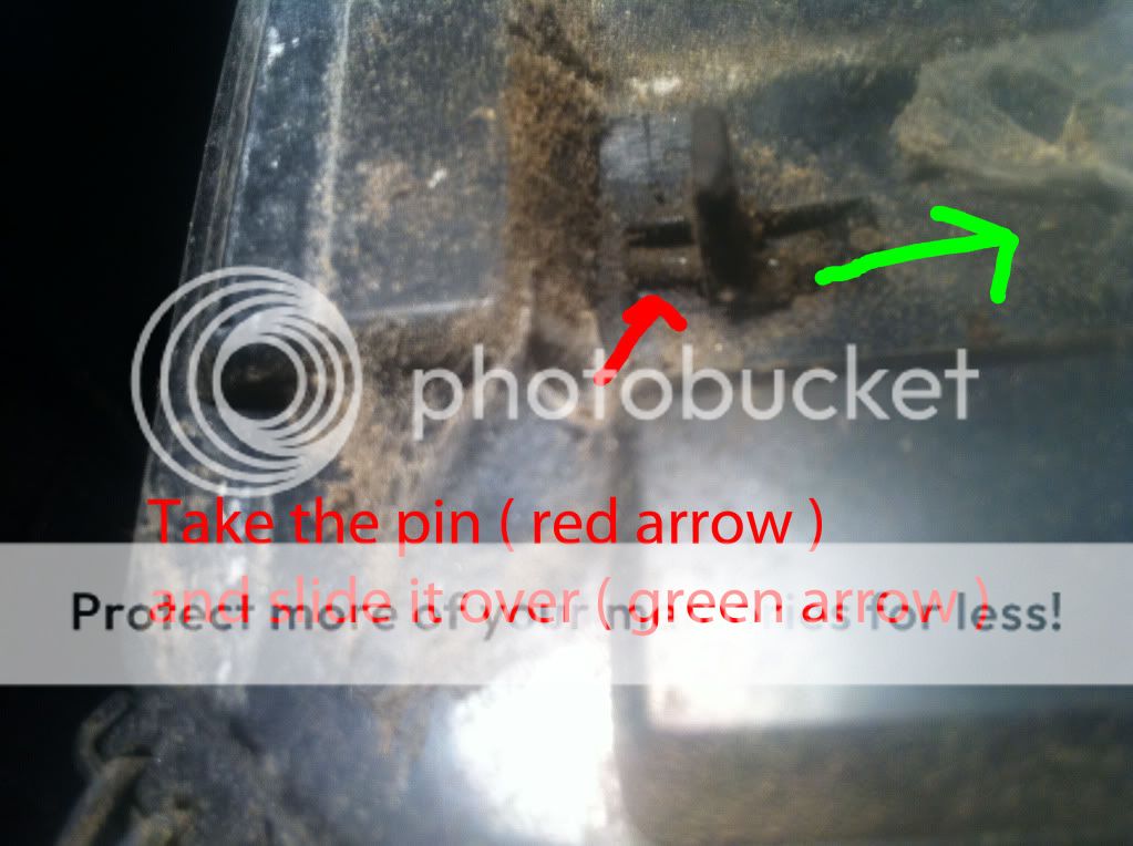

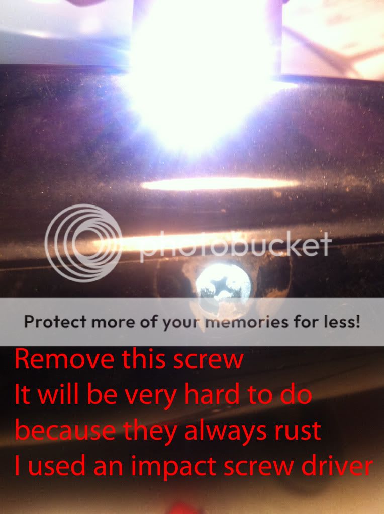

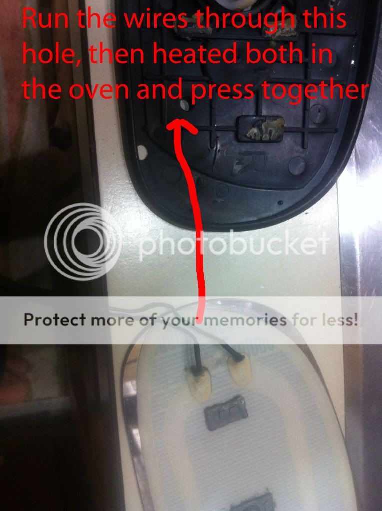

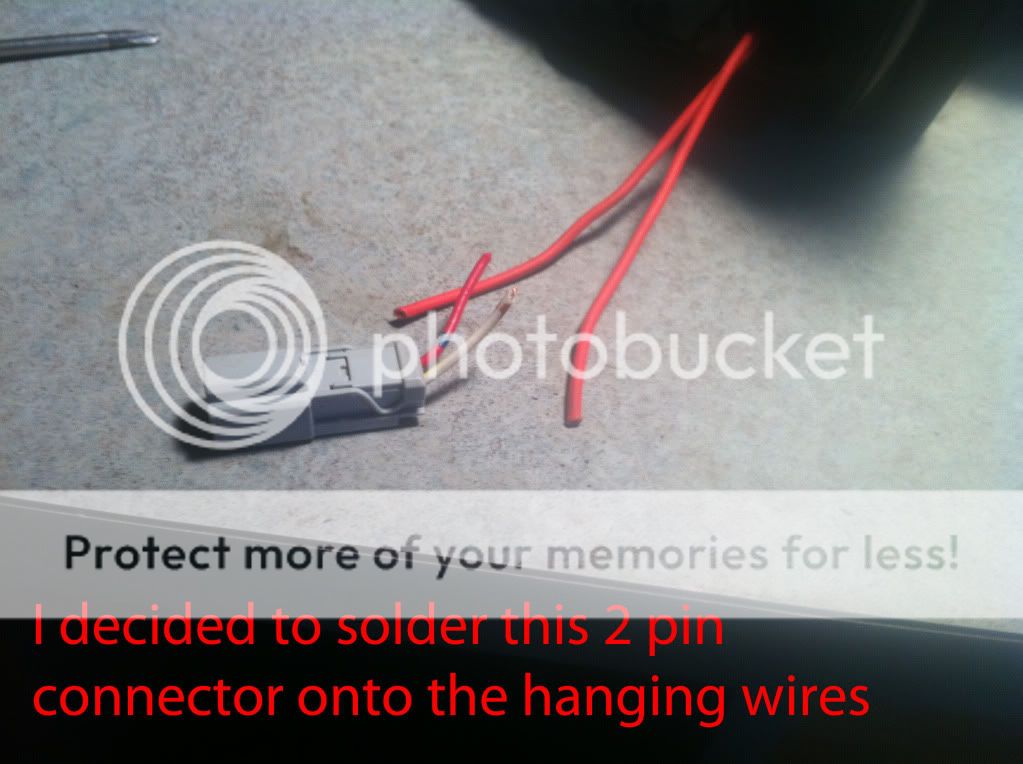

    So i decided to get smart and just type everything on the pictures
    This is only for installing the glass, not wiring them to actually work. That will be another DIY
    Materials:
    1996-1998 acura 2.5/3.2 heated mirror glass
    solder
    shrink tube
    about 2 feet of thin wire
    Tools:
    Philips screw drivers
    flat blade screw drivers
    soldering iron
    oven
    hands
    brain
    YOU WILL NEED TO KNOW HOW TO SOLDER, using cheap shit clips is not an option due to the small space inside the mirror and interference that could be created by a large wire clip thingy.

        I give you big props for doing this and making the DIY but this seems like SO much trouble... Maybe it's just me, lol.
        It only took me about an hour to do one mirror, and that included taking my time and taking pictures

                              The mirror switch uses 7 wires and the heated mirror uses 2 wires
                              In the later acura honda cars they have one connector of 9 wires, the 97-99 acura CL is on the left and the stock one is on the right
                              that is a female 2 pin connector hanging off out of the picture a bit
