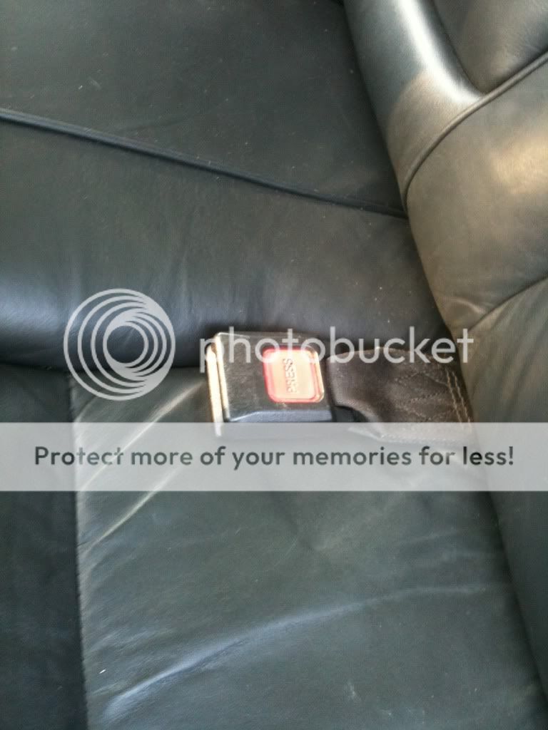

    Finished product ( Left side seat )

    I don't get it. What do you need the DA seatbuckle for? And you need better pics that show what you're doing better...

      the da buckles aren't sewn together so they can be separated.

        The center buckle on the CB is combined with the driver's rear buckle.
        If you replace the CB buckle with the DA buckle, you can completely delete the center belt rather than tucking or cutting it off.

          Ah. I see what you did here. Very clever.

              So you traded the double buckle for a single and then removed the center strap, right?
              I just removed all the rear buckles, lol. No one sits back there and it's less wait.

                Yes thats exactly what i did. The center strap is also sewn to the passenger buckle. So you need both rear DA buckles. I gusse i should include that up top.
