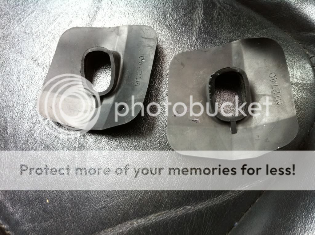

1991-1995 acura legend turn signal/wiper boots
Or
1992-1994 acura vigor rubber platesTime:
2 minutes

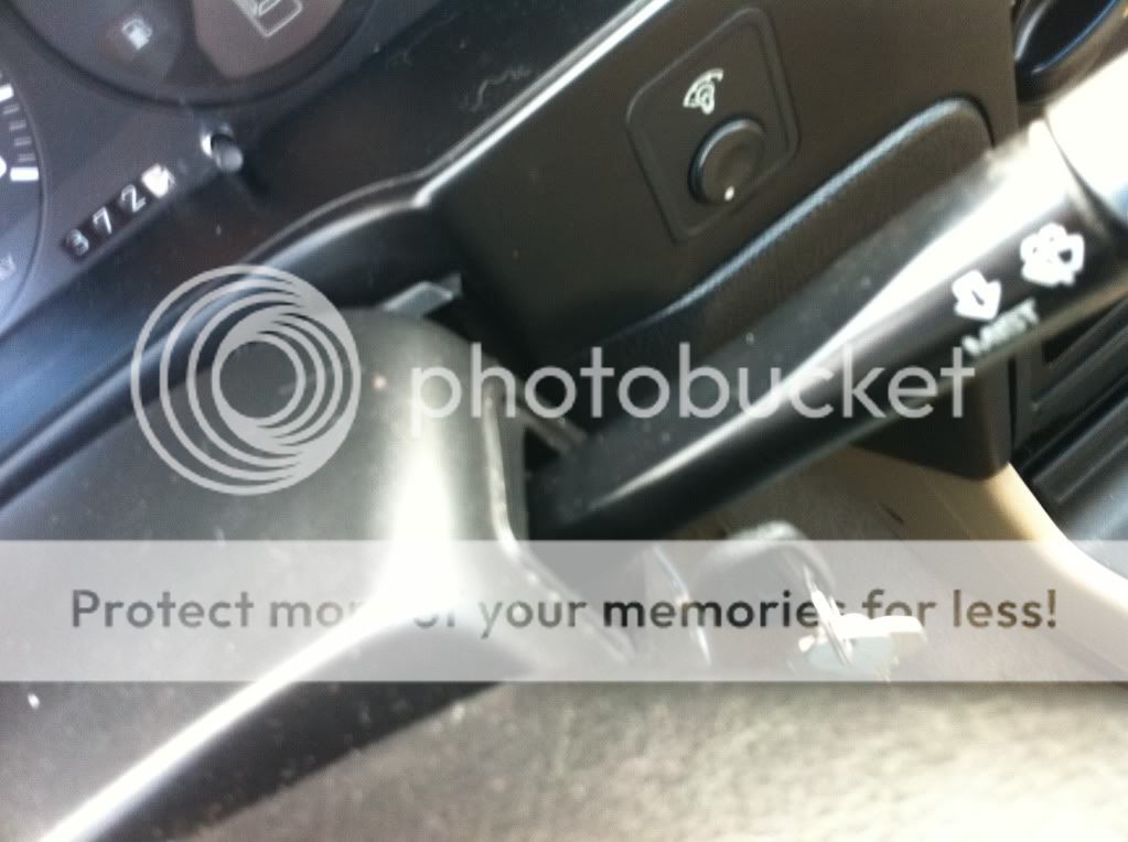

Step 1: Look at how ugly your wiper switch is...
Step 2: Get these boots

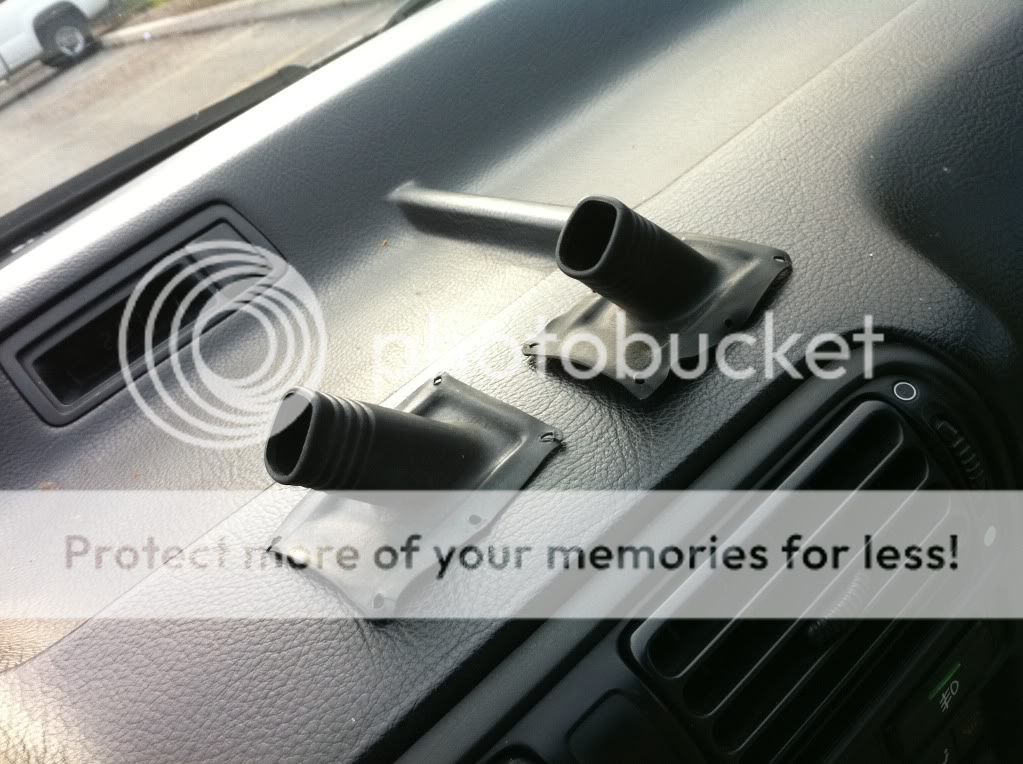

Step 3: Turn them inside out and unroll them onto the stalk. Then pull on them. Be careful not to rip the boots
Step 4: Admire your work
Alternative, if you don't like the acura legend boots you can get these rubber block offs from a 92-94 acura vigor, this way the area leading into your steering column is blocked off, looks much cleaner without adding a different look overall to the stalks
