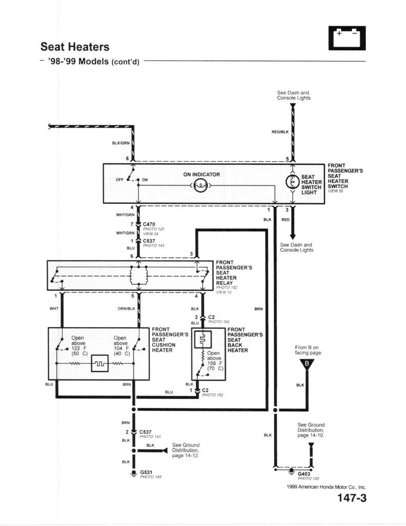

If you find a set of front seats from a 97-99 Acura CL, they bolt right in (at least they did into my 93 SE coupe). I lifted the rear of the seat some to install the front two bolts loosely, then dropped the seat down and was able to install the rear bolts without having to modify the holes. Be sure to at least take the pigtail for the car side harness. Wiring diagrams for 1997-1999 Acura 2.3 and 3.0 CL power and heated seats:
