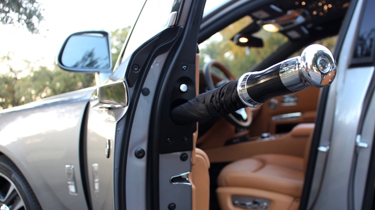

Actually even though I never drive the CB7 in the rain anymore I couldn't help myself and created this trunk mounted umbrella storage sleeve. The idea came to me when I viewed some pics of a "Rolls Royce Umbrella Door" (of all things) that had round umbrella storage pockets in each front door. They were located in the doors above the latches so the only way to get to it was to open the door and press the end of the umbrella as you would a button and it partially pops out to facilitate access. A novel idea to be sure but not one I cared to duplicate on my car.

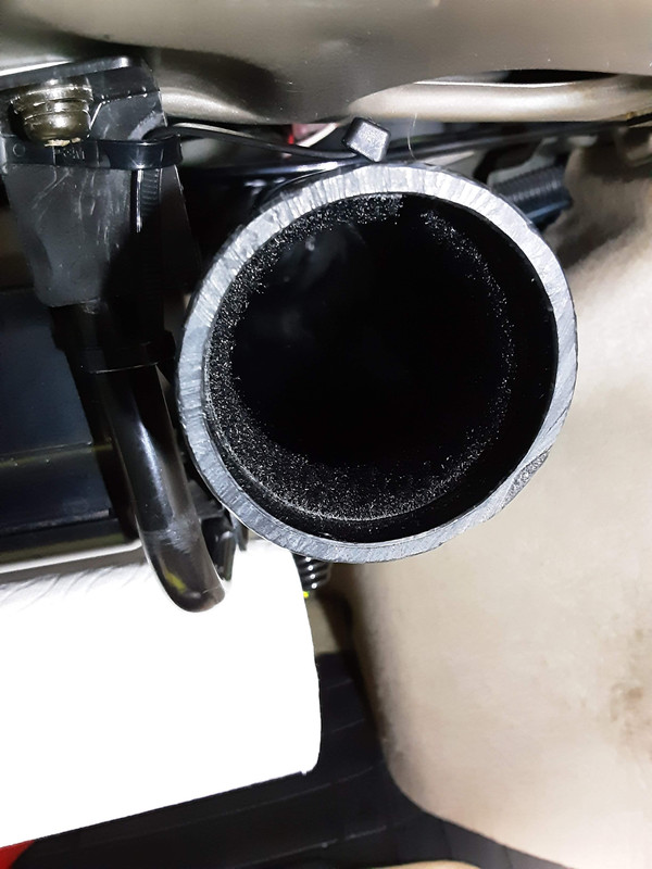

Since I've always kept an umbrella or two in the trunk anyway this idea seemed logical and easy. So with a single 2" diameter ABS drain pipe one end cap and a fuzzy piece of Velcro to keep the umbrella handle from rattling, I proceeded to install it using wire ties to the side of the CD changer. Which unfortunately may limit this to a small number of you who don't have one. But perhaps for those with more imagination another way can be found to fasten one below the rear package shelf instead? Just be sure to install it low enough to clear the trunk lid torsion springs as they make a lot of noise when they rub against ABS (don't ask).
