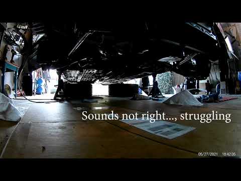

        Ok. So today we popped on that part and started the car. It was not happy........ It idled really low and rough until temps went up etc. & the intercooler is all disconnected. It still runs like shit and doesn't want to stay idle on it's own ......

        But after a bit it started to develop a noise on the cam shaft corner. What ya'll think. Belt too tight? Bearing? It sounds like a failing PS pump, but that's not connected.

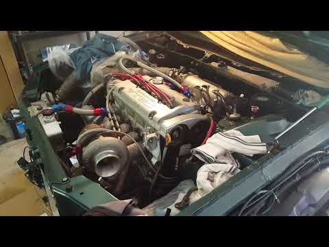

              Yep. I edited the post above to show the car starting vid. One of the cameras did catch it. And last night / this morning I spent the whole time loosening the timing belt. Wow, first time I did that with the engine in the car haha. Pretty sure the engine feels easier to move, that belt was quite tight to get on with no tension at all. Almost done and I'll post some starting vids later today. Oh, also can't really find the oil leak. I think it's just the corner of the oil pan.

                  I got some vids this time of the initial start after belt adjustment. Still kind of running like shit? I dunno. Sounds like it's learning or IACV is not working. Going to put the intercooler / piping back on and troubleshoot from there.
