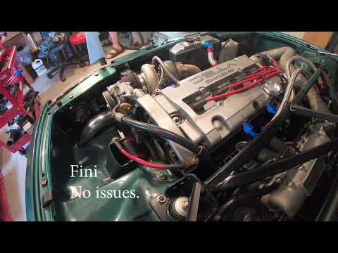

      Going through these timing belt "learning" reminds me of when I was young and over tightened bolts all the time. So I will admit I did re-do the timing belt again because after driving it down the road again I wasn't happy with the timing belt sound & I could smell some burning rubber. Sooo I ripped into this again, got some advice of some folks, and pretty sure I got it this time. Enjoy !
