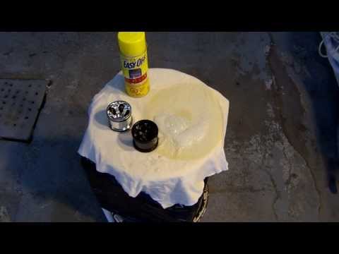

              For stripping the chrome plating, you could use bleach (takes a while), Castrol Super Clean, Purple Power (straight, not diluted) or Easy Off. I'm sure there are other chemicals you can use, I have always used Easy Off when working on my RC stuff. You can almost sit there and just watch the chrome melt off before your eyes. Castrol Super Clean also works really fast from what others tell me and videos I have seen, but Easy Off is more readily available for me. These chemicals will not hurt the plastic underneath the chrome plating. Sanding that stuff off really sucks.

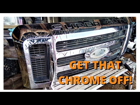

                          Well shit, I was about to dip these chrome pieces in chemicals until I seen this haha.... oooo boy.

                              Ok.. so not doing that heat gun / chrome thing. I tested that on the Honda emblem and it just melted the plastic under the chrome haha. Like the oven trick there's a fine line between chrome coming off and plastic melting. So don't think there's an easy way to rid the chrome except good ole fashion elbow grease Still thinking on this. My issue now is that I can't find the suggested spray can clear coat ... or one that ships to Canada.

                                I don't mean to sound like a broken record but...
                                There are a few different methods for the chrome plating. What is on the Ford truck in the video and some other vehicles grills is different than how your headlight trim was plated. The headlight trim is plated like the R/C rim in the video above.
                                That sucks you can"t get the Majestic headlight coat, sorry man. The 2k clear should give you what your after and look great.
