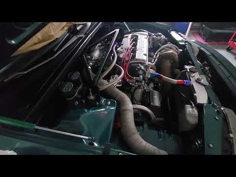

    Well....I'd say Sally is pretty much dying to be repaired now haha. Took her out for a last run yesterday. Was a bit too hard on her and now she has some more symptoms. (and... lost a mudflap and inner fender plastic guard while going far too fast. Went back to get them, the mudflap is ok, the guard is toast. ) Some different sounds in the engine... , at 3000rpm she's super rich. Like... an exhaust bolt broke for example. But meh.... I was ripping through an intersection in 2nd on redline and missed 3rd. Ohhh 3rd gear isn't happy now either. And..... let's be honest. This is 400HP for the past ... 8-9-10 years? Ripping on it every time I take her out. & the head was never built. So... 30 year old OEM / head on 400HP. Enough said. Was super fun to to this project! Expected this to happen one day.
    Sooo.... not sure what her issue is now but doesn't matter. Need to rip in to this thing and do the rings (which I have never done). .... Even with cell phone pics the writing is on the wall (inside and outside 3 & 4 )...
    #1 & #2 - clean.. silver piston tops / can read the serial numbers, clean-ish outside.
    #3 & #4 - oil dying to escape. Everywhere! forced up the threads. Absolute mess...
    Down the engine side of #3 & #4 oil seeping out through the valve cover in a spray / mist / on the fuel rail, etc. The catch can filling up on every outing! Obvious #3 & #4 rings are packed with junk and need to be replaced. Also... probably worn.
    And the head needs to be built! So.... new rings (& bearings), built head needed, ... just debating how much I want to do on my own here. Tempted to try it all on my own.
    Oh ya... we are now in the realm of "let's make a reliable turbo H22 with used parts". (car = old = parts = old / used). IE: pretty sure cams don't have bearings and the worn part of the head = not worth fixing?
    See if your ear can pick up the.... 5 tick...sound but skips a tick, then 5. There are many sounds that shouldn't be here now... haha
