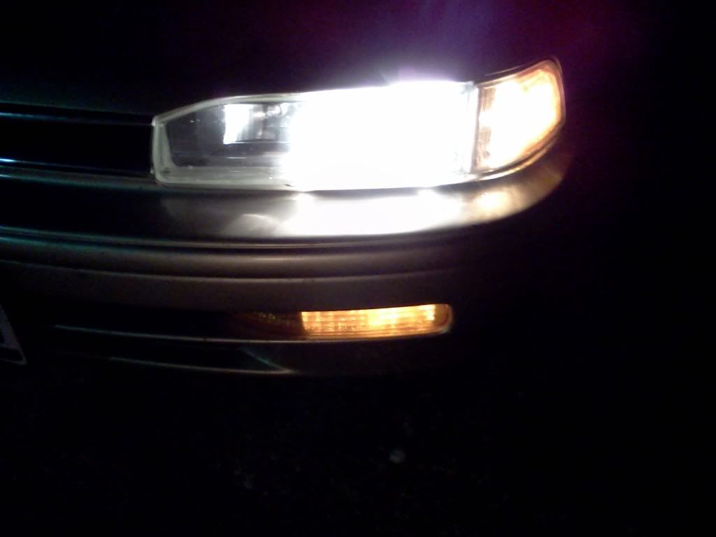

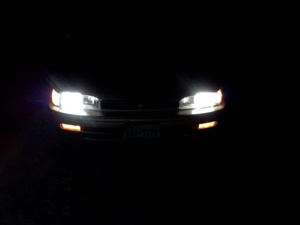

  • wildBill83
    replied

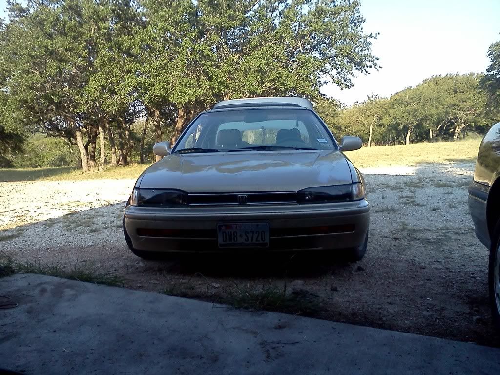

    Installed blackhoused lights and 3 wire bumper signals:

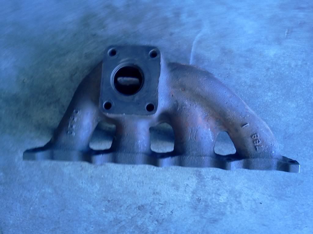

  • wildBill83
    replied

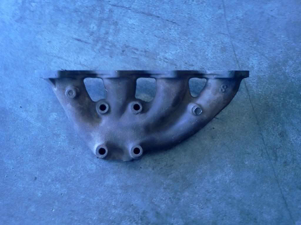

    The DSM manifold for my mild turbo project. I have three, but this one has the least amount of cracks and also the smallest exhaust port. So I'm going to start with it and have one of the others welded if I get the need for a bigger exhaust and more boost.
    I'll try and dig out the other two if I get bored and the turbo I have as well. The plan is for 8-10 lbs of boost once I put in some better pistons. This is down the road maybe two months or less if I get the job in Houston.

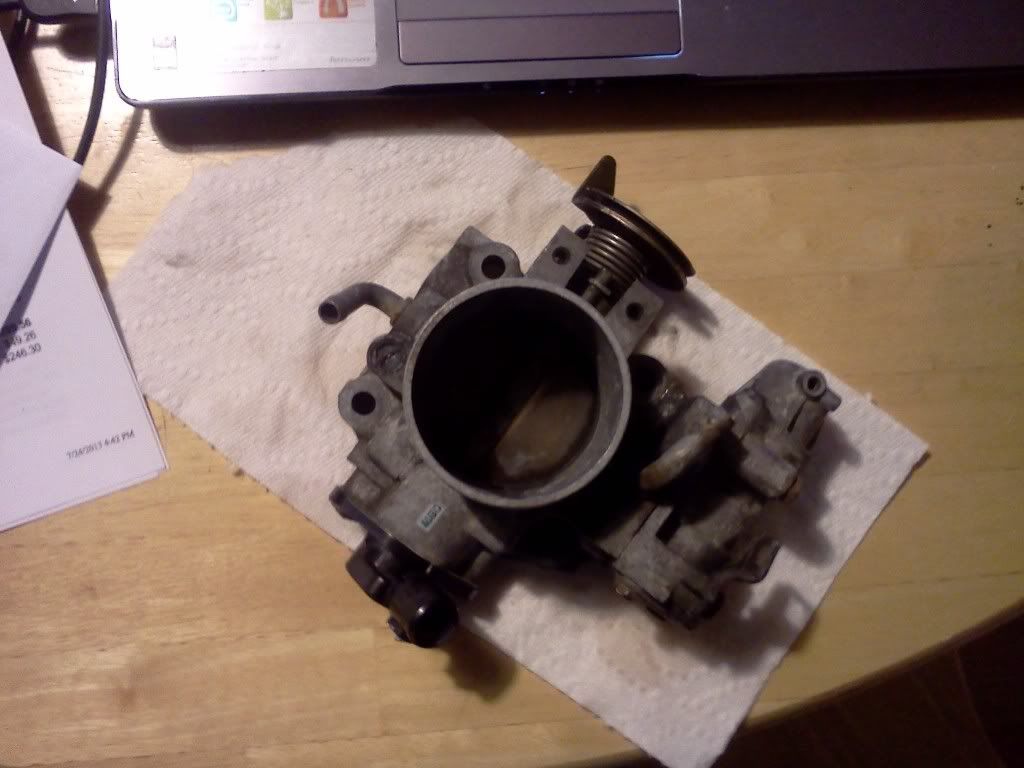

  • wildBill83
    replied

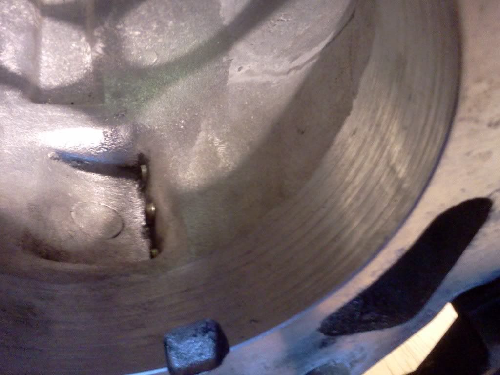

    This is the Prelude type SH throttle body I'm matching the plenum to. Both are 62mm now.
    I'm converting the FITV using F22A* internal/external parts and have plugged the MAP port with JB Weld. So essentially it is an OBD2 setup that will work on my F22A6 turbo build.
    The last time I ran this on my F22A6 in my SE the idle ran funky as all hell and I thought it was the plenum spacer and plenum combo and a vacuum leak issue, turns out it was the FITV had crapped out. I just removed the guts and replaced them from a known good FITV off an F22A1 plenum I had a spare of so it should work now.

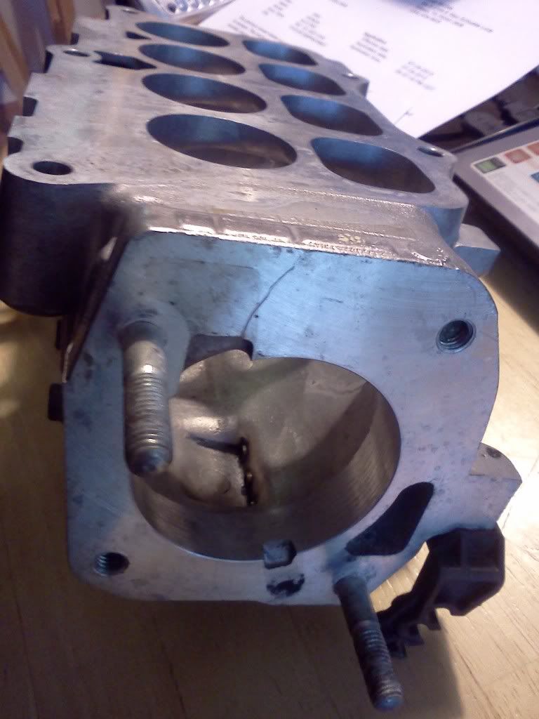

  • wildBill83
    replied

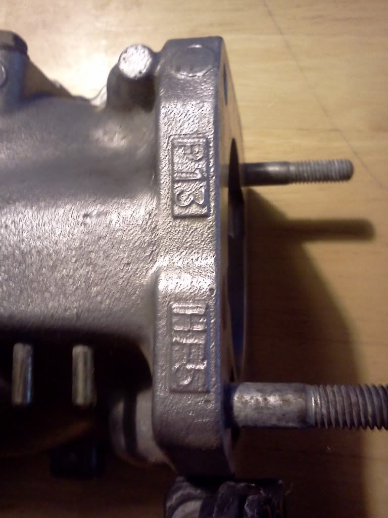

    Got bored and ported an extra P13 HF5 plenum. I have a TB I'm matching to it currently also. This is just busy work to get ready for other upgrades in the future.
    Forced induction should breath nicely through this plenum.

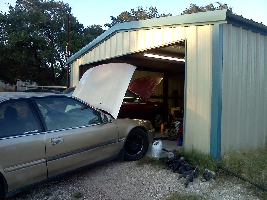

    The decision has been made. The '93 SE coupe is going turbo. I've got about 40% of the parts needed and then the block gets a full treatment with forged internals. This project will go faster if/when I get my new engineering contract, so wish me luck.
    The '92 LX is being converted to an F22A6 as soon as I get the last few items (IM, cam, exhaust) and do the PT3/PT6 conversion offered by cloudasc. The LX will be the home of my conservative N/A H22A4 build eventually.
    So projects are intermingling and going slow as my income is only from part time work at the moment. But the goals are now clear and in this order:
    Drive the SE until my LX is road ready with the F22A6 converted motor, then garage the SE and start the turbo build and mate that to my MP1A LSD transmission. Once the turbo build is complete then I'll garage the LX and drop the H22A4 in that shell and I'll have two very peppy CB7s and a spare very healthy F22A6 for future tinkering.
    When the turbo SE is done, I'll pick back up on my TCU controller but using more reliable electronics.

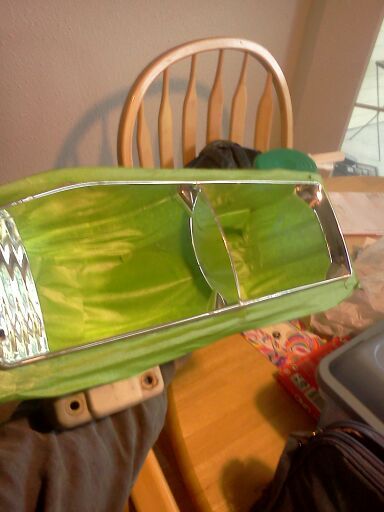

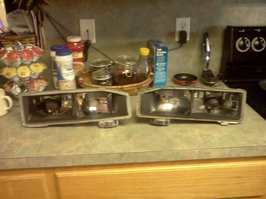

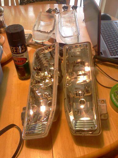

  • wildBill83
    replied
    Black housed my headlights today.
    Weather is nice out so I took advantage of it and painted goodies today, mostly for my sedan but I did my headlights for my coupe too.
    Sorry for the crap quality photos.
