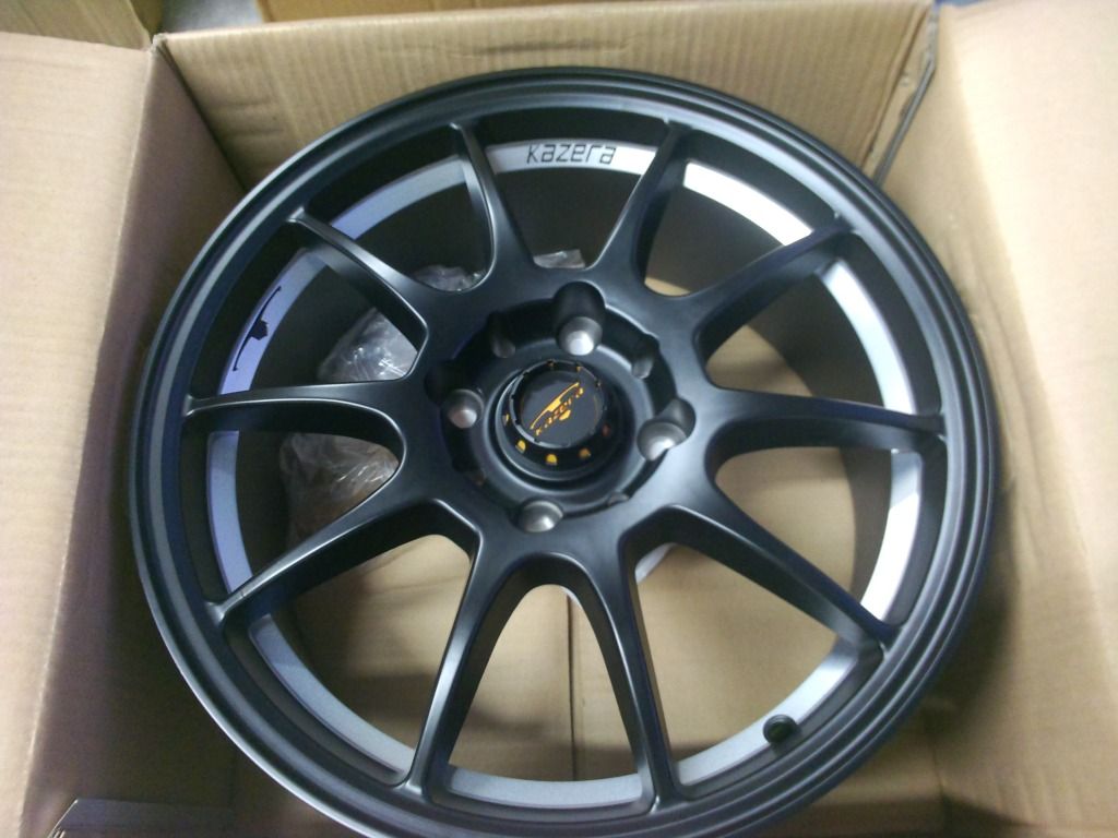

        I put stock rims and tires on and have new tires 205/55/R16 on order for my MB Motorsports black with chrome lips.

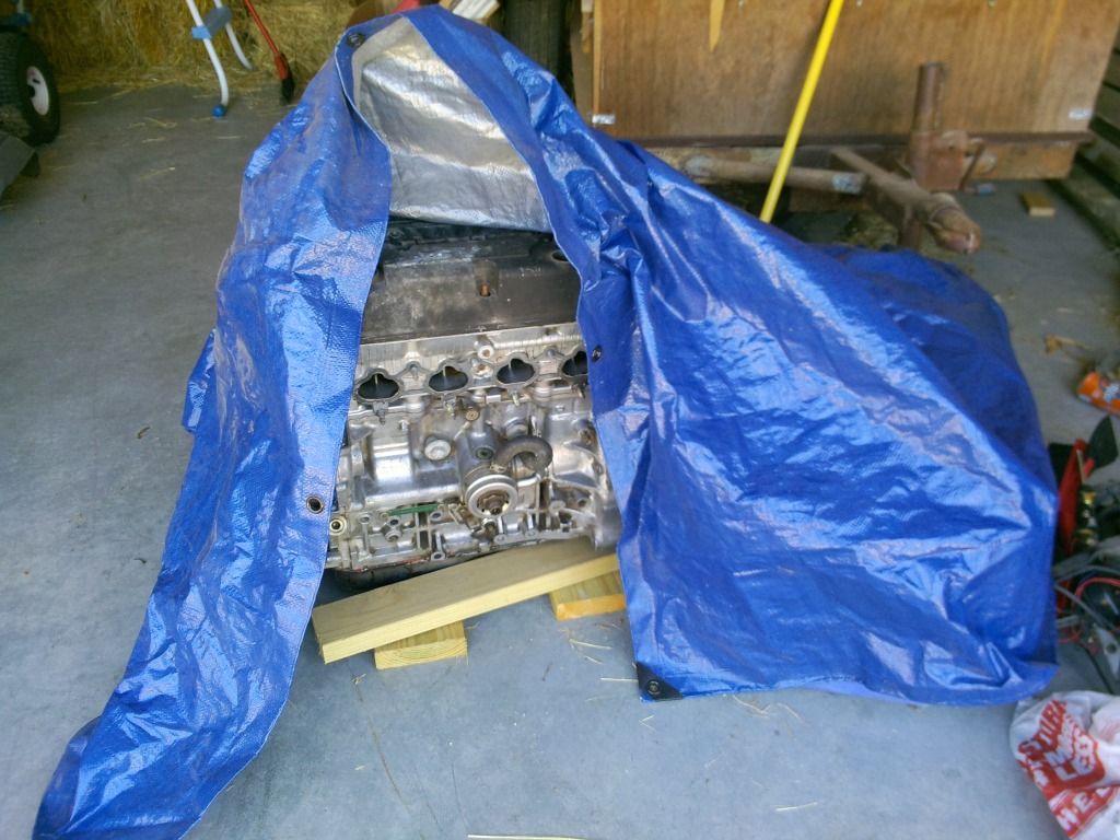

          Pulled the motor and fixed some oil leaks, here is some eye candy.

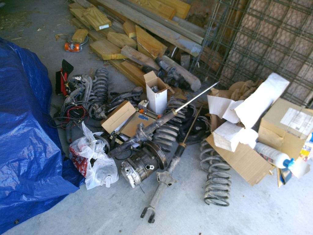

          Some old parts:
          My H22A4 that I've got in the engine stand as of Last week:

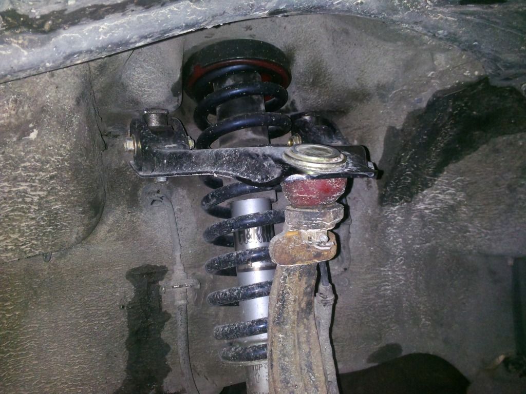

          Rear camber shims, new UCA and all other parts replaced and H&R springs and Koni struts installed:
          Front ingalls camber kit and UCA with poly bushings H&R springs and Koni struts installed:

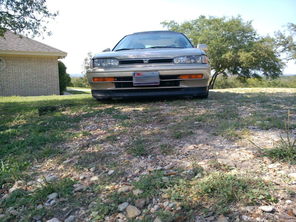

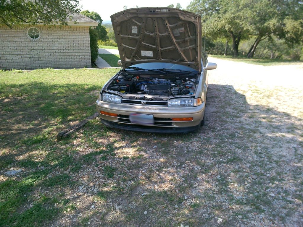

          Front end now:
          Side View:
          Engine bay:

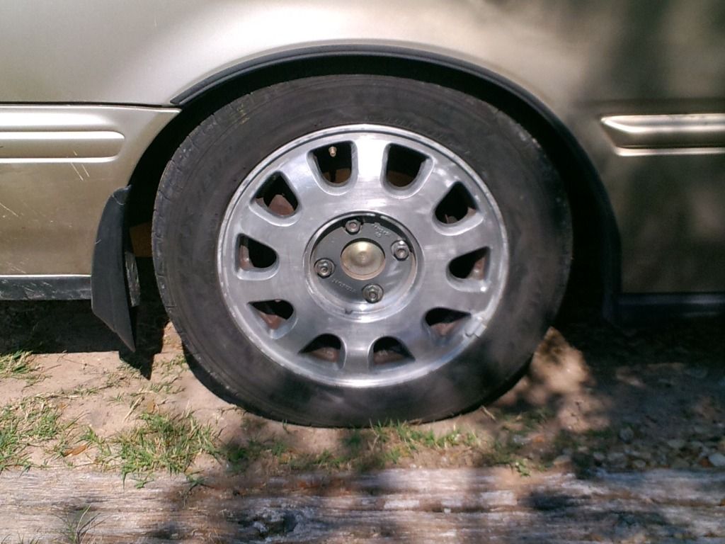

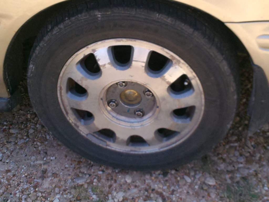

          Wheel restoration progress before:
          Wheel restoration progress rough out during:
          After photos coming soon.

              Wheels look good. I'm redoing mine and it is taking forever but they are starting to look good.
              Which ingalls kit did you get and what size shim did you use in the back?
              Thanks
              Steve
                #52
                thanks steve, I'll be polishing them more tomorrow. I hope to have new photos up soon, been really busy.
                I'm using ingalls anchor kit in the front and 1/8 inch shim in the rear. Sorry for poor typing, I'm on my tablet.
                When I finish the polishing I'm going to repaint the dark cutouts and reclear to prevent oxidation.
                  #53
                  If your going to repaint. I think it would be easier to use paint stripper. I sanded the hell out of mine last weekend and they look ok still not done. But I have no fingerprints. It was a bitch. I used a dremel for the deep stuff.
                  Nice engine too. Good luck. Ill be watching for the wheel photos. I thought about using graphite on the holes but decided to keep it the color it was. I was going to clear them too. But I bought some metal polish and just shined them up. Its prob more work to maintain with no clear. But I like the look.

                    Paint stripper removed the clear coat layer but not the oxidation, also I'm just refreshing the darker parts with the graphite paint. The clear will go on after I polish and buff to lock out oxidation. aluminum exposed to air oxidates, you have to abrasively remove oxidation. It's much better to just polish and clear and then clean often than to have to use abrasives, less material lost the better.

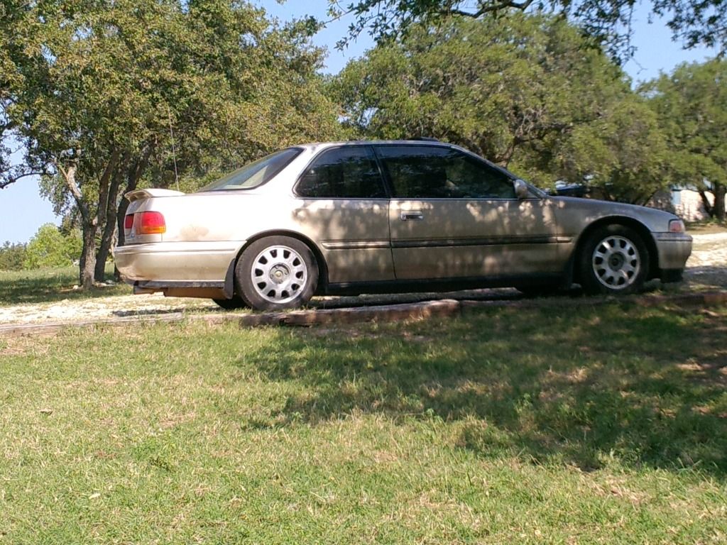

                            My new rimz, tires are 205/55R-16 Hankook Ventus I had laying around. I'll post updates later in the week once I finish a few things on the ride.
                            I needed to put these rims on to finish my polish job, then rebalance the OEM wheels and will store these with the Hankook tires for a few months. Next summer I expect to get to the track.

                              BOOOM.... New wheels on the ride, sorry for the durtyness...
