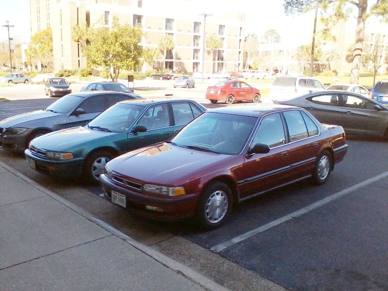

    Ruby and Jade in Pensacola last weekend, a quick additional 1,500 miles. They were both white with salt that morning from the trip down even though we managed to route around the snow storm in KY and TN. 7,000 miles now on the new engine, uses virtually no oil, 32+ mpg coming home. Met briefly with SE Girl to deliver some parts, goofed and didn't get a photo with her car.
