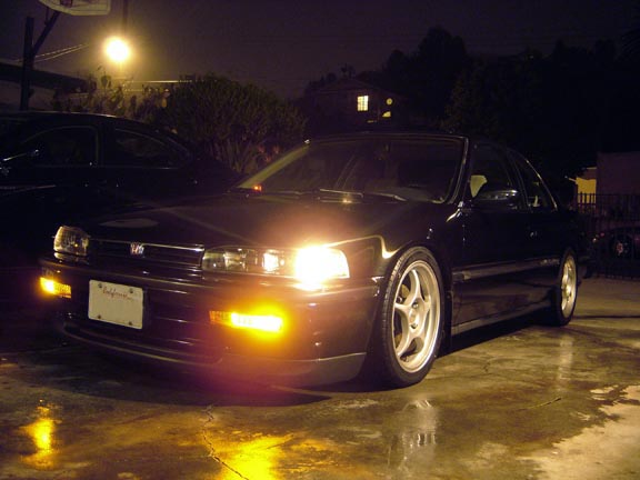

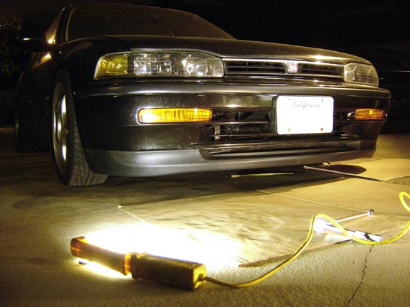

i took off my bumper and started bolting it in from the center out towards the ends. I had to trim a little bit off the tips of each tab to make it fit. Then i used a dremel and drilled thru the tab and my bumper while i held them in the position i wanted and followed up with a power drill to make a bigger hole that my screws would fit thru. I just reused the 10mm screws and washers that came with my ABS Mugen lip.Last edited by lummieCB7; 03-17-2007, 07:06 AM.

i was a little worried about the length of the lip at first but everything ended up fitting real nice.
