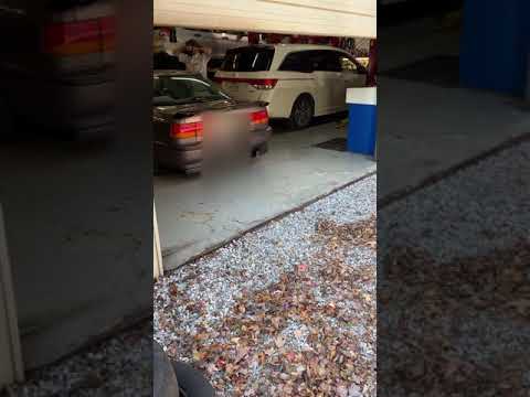

    This is a good exhaust note! I’m glad you finally got it dyno’ed.

    Yaa, your exhaust note is quite different than mine, but sounds good. The volume of growl that increases on your car is cool. & nice curve too. I see you were doing reverse / 1st gear launches on the dyno...

    Finally made it to a dyno, had to drive 45 mins to get to it, since the only dyno in shop is for only RWD. (I know crock of dookie), they are a domestic only shop. Anyways I made my horsepower goal not my torque goal. 314/247 @ 14psi. It was interesting I did 4 pulls and I gained hp and tq on each run without touching anything. The dyno guy said that is probably because I don't normally push it that hard and its cleaning up the plugs and cylinders. Ill go back again sometime next year when I bump the boost up to 18psi. My goal is 350 at 18psi. After today I think I'll be able to achieve that.
    At least this puts me in the top 10 for boost kings lol
    Power band is where I want it and it is nice and smooth, This is also on a conservative tune, I may go back and ask them to make an aggressive tune, that I can switch up on the fly if I want more juice out of it. But all in all I'm Happy.
    Also here is a link to the exhaust note on the dyno run:
