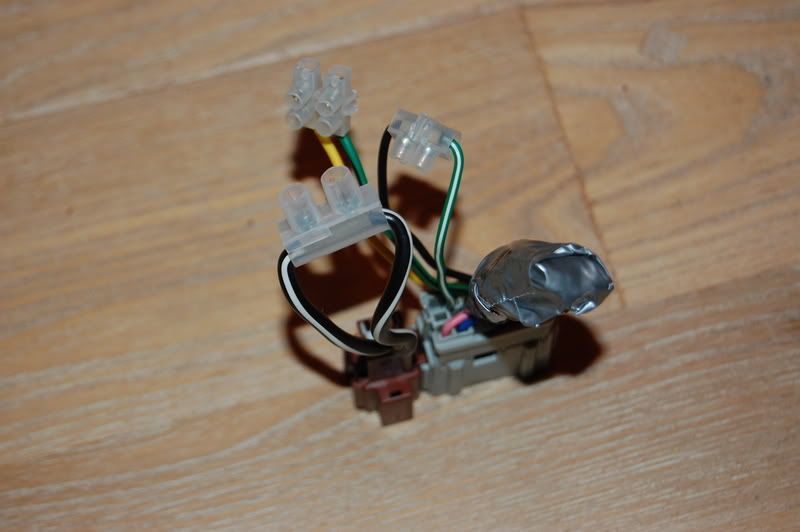

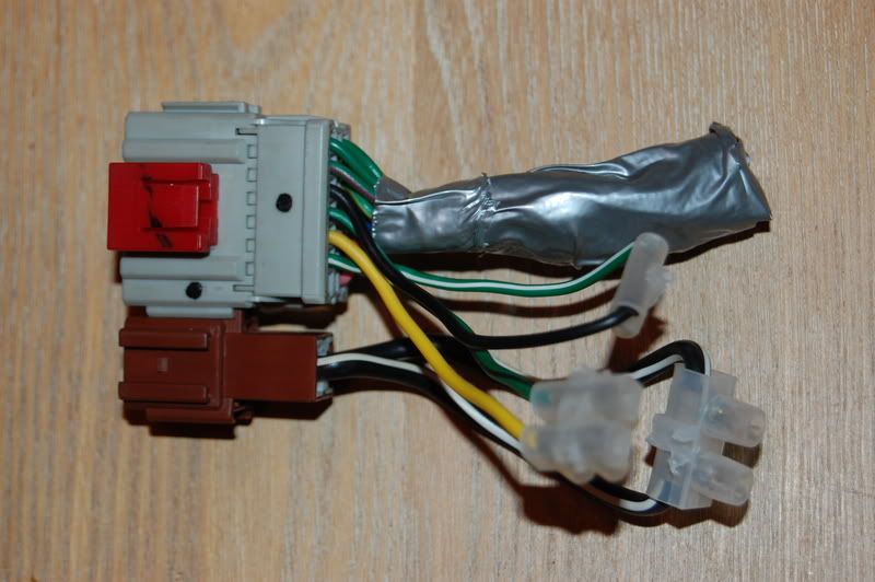

                        #86
                        Originally posted by cp[mike]
                        #1. making the car think that the shifter is in park
                        when you removed the auto shifter, u disconnected a big grey plug. snip the black and green/white wires and connect them together. in the picture, i had cut the matching reverse harness off of the shifter, leaving enough wire to splice to.
                        #2. hooking up the reverse lights
                        on top of the tranny is a reverse lights switch, it has a yellow and a green/black wire. they need to be connected directly to the wires of the same color on the shifter connector. agian, in the picture you can see two black wires coming from the right gegtting spliced in. they run through a hole in the firewall and connect to the wires on top of the transmission.
                        #3. neutral safety switch
                        there was a brown 2-pin connector that went to the old shifter. the easy way to do it is cut the connector off and splice the two thick wires together (solder them!). or if you need to do it the "right" way to pass inspection, follow the diagram below. the "clutch interlock switch" is the switch that gets pressed when the pedal is put all the way to the floor, it has a yellow 2 pin connector. wire colors are indicated in the diagram.
                        [IMG]http://www.****.com/pics/auto_to_manual/shifterplug.jpg[/IMG]
                        Today I got bored and did mine.
                        I did the same as mentioned in #1 in bold yellow.
                        So tomorrow it will be plug and play, I hope.
                        I have also got a new starter now after driving two days for it because they gave me the wrong one
                        So I had to drive twice
