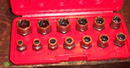

Just bought a set of these "bolt out" sockets from Sears, some Craftsman shit you know. Anyways, I did this cuz the rear caliper bracket bolts off the 88 integra of ours are rusted to shit & the tool that should be used don't work cuz it just wants to round it out. the rust erroded torx bit internal part to shit, so it's some size that don't fit shit.

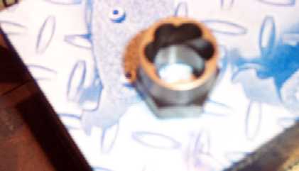

so I put this "bolt out" socket on top the bolt head (has hex-like head that's close to 14mm, not quite) and then back it out after I torched the bolt & bamm!! all gravy...used another socket on the 10mm bolt heads for the dustshield too..worked like a charm.
so it works like it supposed to...it can be used for rusted out bolts/nuts or if you round the bolt head or nut out.
) I just used them to finish the rear brake job on that 88 integra we have. I successfully removed 12 bolts in whole (they threaded out) that were all so rusted to hell, I could not fit a combo wrench or socket of the appropriate size cuz they erroded to some small oddball size that fit nothing! they came out with ease baby, with ease.
