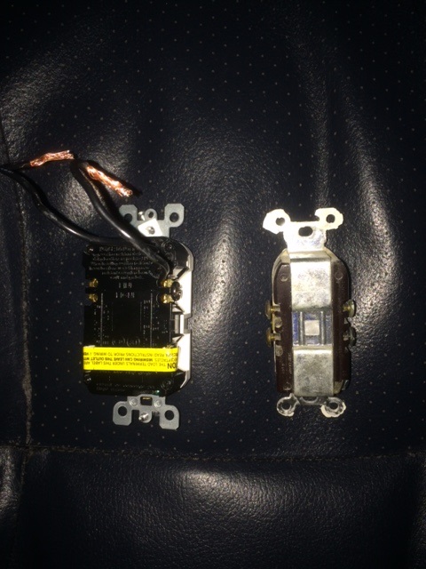

I just replaced the archaic non-GFCI combo switch (light switch and outlet) in my bathroom with a new Leviton GFCI unit. The old unit worked, though the plastic around the outlet was damaged, and the switch was definitely wearing out. Since it's near water, I'm required by state electrical codes to have a GFCI outlet.
Anyway, I installed the new Leviton GFCI unit, and the switch works great. The outlet has no power whatsoever. I even bought a new one, in hopes that I just got a dud. Same result. I followed the instructions in the package to the best of my understanding. The wiring is pretty straightforward, especially since there are no other outlets beyond this one in the circuit.
I've never installed one of these things before. If I'm making a stupid mistake, I'm missing it. If anyone has any experience that could give me some advice, I'd be extremely grateful! My wife isn't happy that she can't dry her hair in the bathroom...
Here are pics of my wiring. Sorry for the rotated pictures. They didn't show up that way until I uploaded them, and my FTP program keeps crashing.
Of the two cables running in from the bottom of the box, one looks to be straight to the breaker, and the other looks like it might run into the kitchen (which is on the other side of the wall from the bathroom.) I'm assuming the cable entering the box from the top is going to the ceiling-mounted bathroom lights.
