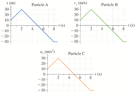

    for some reason, I can't get the right answer...its pretty easy.
    Just look at particle (c)
    v initial is 10 m/s at t=0 s. What is the velocity at t=6 sec?
    If you could provide an explanation, that would be nice. Thanks

    Wouldn't that be 60m/s??

        Is it 70m/s?
        Any other info they gave you would be helpful.
        Are you working with vectors?

            god, my damn messed up calculation...the answer is 90 m/s...

              this would work, assuming you knew the exact acceleration at t=6. from the graph you could say its -10

                OK... I got it.. lemme type up an explanation
                  If you look at the graph, its giving you the acceleration... How much it is increasing per second.
                  your initial velocity is 10 m/s.
                  Now look at the graph from the first point to the change of slope. You went from 0-2 seconds, and the acceleration went from 10m/s/s(squared) to 30m/s/s. So the average acceleration over that period of time is 20m/s/s. So 2 seconds at an avg. acceleration of 20 gives you 40m/s faster than you started (50m/s).
                  For the next two points, you do the same thing. You also get an average of 20m/s/s. Which adds another 40m/s of velocity. Add that to the 50m/s you started with, giving you 90m/s. The final two seconds will give you an average acceleration of 0m/s/s, so the velocity does not change.
                  You could also just average the whole last 4 seconds, but 2 seconds at a time was easier to explain.

                    K .. I'm lost .. why does it appear to start out at -30 ?

                      You gotta read from left to right meng. They all start out at 10.
                      a. is position
                      b. is velocity
                      c. is acceleration
                      edit: if you need it more explained lemme know.... not you tomi

                        nah, i got it...there is a simple way to do it. Since all u can do is look at the graph, you just find the displacement (area) from time 0 to time 6. since 5 to 6 is a negative number, you add it to the number you find from 0 to 5. Then since the initial condition says that at t=0, the initial velocity is 10, then the answer will be 90. Thanks for ur guys help though. I was dumb and made bad calc errors.

                          oh yea aero, you would be right, but in this problem it is asking for instantaneous velocity. I think thats what ur saying?
                              Yeah, you can also do it that way... taking the area under the curve.
