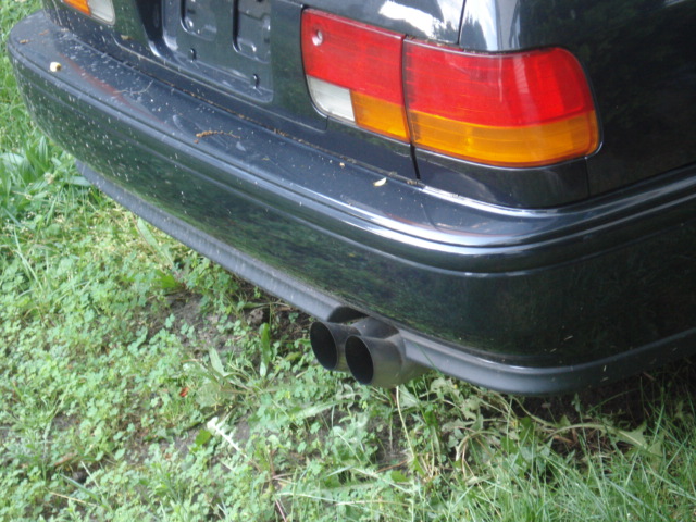

            ive always liked how DTM tips fill the hole and protrude just enough, and it helps when backing into a parking spot, theyll slide up and over the parking block if you get that close
            ^-----That fitment isnt the best it could be
            v-----more like this

              I do really like what i see with the DTM tip, its the exact look i want but ill need a muffler to go with it for the noise i want, not a fart can but something to make it purr just a bit louder and a bit deeper (if possible).
