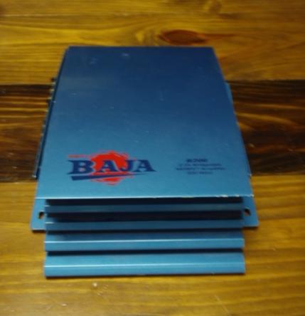

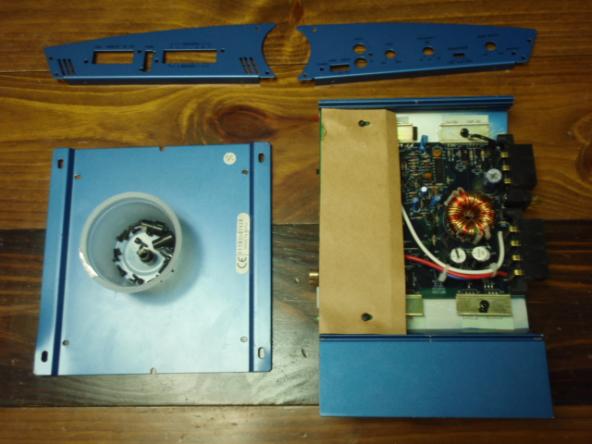

    I was thinking about taking this old amp and make a custom housing for it. I was thinking about using Plexiglas and led’s. What do you think??

    Go ahead, But you will need to add some fans in there because the metal casing is used to keep the board and mosfets cool.
      I think that'd be sweet, if you make it out of plexi, make the case bigger, add a couple fans, hook em to the remote wire, so when the amp comes on, the fans come on. The bigger case will allow for more air flow, shouldn't have any heating issues.
      Keep us posted
        The metal case is a heatsink, so like bruno said, you will have to add some fans or a custom heatsink
