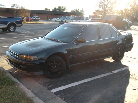

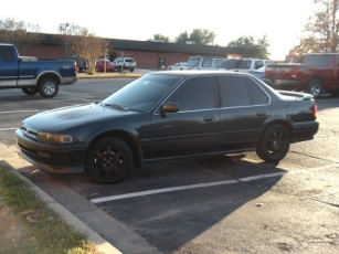

my cb7 jus painted the rims

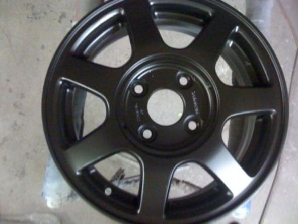

    heres my cb7. this is when i put the last coat of black paint on.

    steps on how you went about painting them?
      i sandblasted all the rims cleaned then primerd them resanded just to smooth the primer then shot the black paint i used 3 coates of black paint

          closer pics plz. did u mask the tire off?
            alright ill get closer pics. well i dismounted all 4 tires i work at a dealership so i dismounted them for free lol

              lucky you, i just tape them up. take longer, but thats all i can do, i dont have access to a shop like u do
                    lol yea but it took me a while to prep them and stuff i was taking my time i wanted them to look good. i also had to balance them with stick on weights so i couldnt see the the weights and scratch the paint
