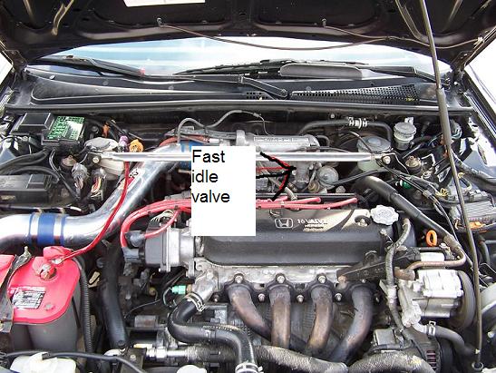

          do u have a picture of where its located??

                heres a pic

                  Correct - You remove the top 2 screws, and very carefully tighten down the white nut peice in there. When i had the top off i actually put bolts on there, so its easier to access. If you need more help, lemme know.

                    lol that was so simple my idle has been messed up for a while and thats what fixed it
