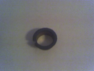

I need help. I'm doing a motor swap, the motor I'm putting in my car was from a car with an auto transmission, well the one I took out was a manual. My question is this: In the flywheel, there is a bushing that keeps the output shaft from the tranny aligned... any ideas where I can get one? the local auto stores around here don't even have anything listed. Any help would be greatly appreciated. Thanks a ton!!!
Flywheel bushing
Im not sure what you are talking about. do you mean the pilot bearing?
the pilot bearing is what the flywheel bolts onto

There is no pilot bearing on our cars, And that bushing is something wierd.Originally posted by Night WolfIm not sure what you are talking about. do you mean the pilot bearing?
The only bushing I remember seeing behind the flywheel is a thin plate that goes on the end of the crankshaft and sits between the flywheel and the crank.
Originally posted by bruno8747There is no pilot bearing on our cars, And that bushing is something wierd.
I didnt know that

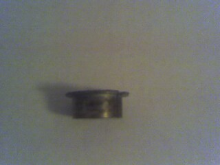

The flywheel is bolted onto the crankshaft, Then the clutch and pressure plate is bolted onto the flywheel.Originally posted by nine_deuceThat little bushing that I took pics of keeps the flywheel from slopping around on the shaft in the transmission. Without that, it just flops around. Could it be a shim of some sort? this is driving me nuts, thats all thats keeping me from getting my transmission bolted to my new motor
The clutch disk is has splines and the transmission input shaft has splines. They go together and no busing is used to keep them together.
That piece of metal IS the pilot bearing and it fits into the flywheel's center to give support to the end of the input shaft.
My ACT flywheel came with it pre-installed.
Perhaps the pilot bearing is like the TPS sensor in that it cannot be ordered by itself, and can only be purchased with a throttle-body assembly, or in the pilot bearings case, a new flywheel. IDK for sure, just speculating.
ive never seen one of those things used on the transmission before... did that come off of an oem flywheel?
I'm not sure if it was the OEM one, the guy at the Napa here said that he's seen them used before, but that particular one was an after market piece... but they do use them... I'm thinking they use them on remanufactured fly wheels... but its a pain in the ass. What I got from the little speech he was giving was this: when the fly wheel gets used, they use that shim in the output shaft slot so they can continue using that particular fly wheel, rather than use a new one
