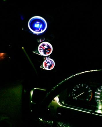

i was wondering wear i can put my aftermarket water temperature gauge. and my oil pressure gauge i was wondering if i would need an adapter for theoil pressure gauge
gauges
I put mine in the cupholder aera.
If it wasn't included in your kit, you will need a 1/8" nipple fitting and a 1/8" female tee adapter. You take the stock oil psi sender out (above the oil filter, can't miss it.) and put the nipple fitting in the hole. than the T. on one of the T side you screw the sending line or electral sender. on the other the stock oil psi sender. like this, []-T, [] being your engine block, - being the nipple fitting, T being the Tee...
Im not sure how to hook the water temp up though.
Edit: better pic...Last edited by EJX_Michael; 07-15-2008, 05:58 PM.
