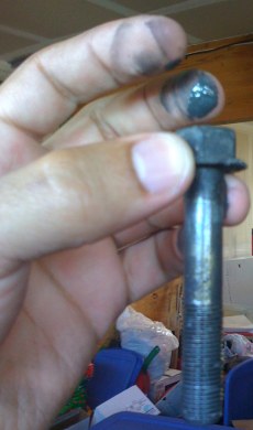

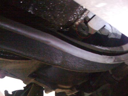

    A bolt on my transmission managed to unthread itself. I only noticed because my car starting to make a grinding sound, which is probably due to the transmission fluid that leaked all over the bottom of my car. Oddly enough I never saw a puddle of fluid in the drive way at home or work. I did change the trasmission fluid a couple months ago, but it is not one of the bolts you loosen. This bold can only be seen by looking towards the passanger side from the drivers side. When I got underneath to inspect it came right out without any unthreading. It also had this gray this fluid all over it.(See Picture) Any ideas why this would happen?

    maybe it just came loose over time. But if its not one of the main bolts that hold the tranny to the block then it looks like it could just be a bolt that holds the rear motor mount bracket to the block.
      Looks like it holds the casing together....

        The quick answer is that if the bolt came out w/out use of a wrench, then it probably was not tightened to specifications...
        If you are absolutely certain that you never touched it, then there has to be some other explanation. No matter how tempting it may be to believe, no bolt on any car SHOULD free itself.
        I imagine anything is possible as always, but have you been able to put it back? Try to get yourself a Factory Service Manual or a Chilton's.
        I bought a Haynes myself, but there are always inconsistencies so I don't really recommend it if you are serious about having the correct information on the first try.

          That is one of the housing bolts.
