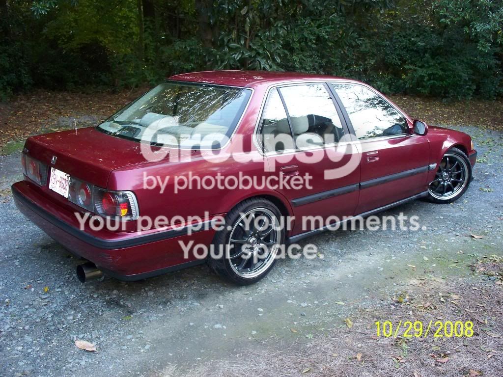

            Alright, so if everything works out right I may be buying my new shocks, finally, this weekend. I'm considering either the KYB GR2's or the Tokico HP's since I can get a full set of either for $200-$250. Which do you think would be the better choice? I'm also considering taking my coilovers (sleeves) off in the future and replacing them with Eibach Sportlines so which one of these shocks will hold up the best if I put these springs on? I'm definitely happy about the stance that my CB has since it was lowered so I don't want to compromise that but I am tired of the blown shock situation after a year and a half. Anyways, here's the stance that my ride has right now...
                thats how my car looks now on gr-2 shocks & neuspeed race springs.
