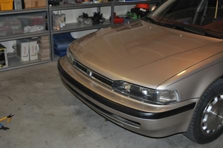

JDM lights not linging up right. I have a 92 Accord CB7 Wagon. I bought some JDM black housed headlights and they are not lining up right. Any thoughts on why this is happening? They look installed, but not finished as they should since they are Stanely...

I htought 90-91 have chrome trim around them? Are his missing the trim?Originally posted by TypeG View Postyou have the 90-91 headlights instead of the 92-93. they are different. later.
That would make sense. The driver side i couldn't get al the bolt to align either. So the 92-93 sedan headlights should work right? THANKS AGAIN!!! I thought i was going crazy! I will pull the headlights and resale them...Originally posted by TypeG View Postyou have the 90-91 headlights instead of the 92-93. they are different. later.
