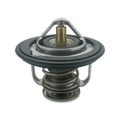

    im tired of waiting 7 minutes for my car to warm up so im gonna replace the thermostat tomorrow but i need help with what direction the thermodtat should be facing.
    the bigger disc lookin side should be facing into the engine or coming out of the engine.
    i know the pin has to be facing up but what dirrection should the side of the pin be facing.
    im pretty sure its not good to put it backwards.
    thanks

    The spring facing into the block, with the metal nipple facing outwards . Mine takes ten minutes to reach operating temp, lucky you.

      another question ,, the seal has a flat side ,, that flat side should be facing the flat part on the actually thermostat ? correct me if im wrong please

        I thought the thermostat slips into the seal. The little jiggler goes to the top. But if you got the el cheapo gasket, it might just be a flat piece of rubber
          thanks for the pic and no ,, i actually have the same one on that pic ,, where the seal sits on the thermostat is actually a flat part like i said
            no problem, double check it. My felpro has 2 flat parts and the stat slips up in there just like in the pic, the rubber isnt just balancing on the stat its enveloping the outer edge.

                make sure you go to Honda and get a thermostat. They're only 24 bucks and come with a gasket; a comparable Autozone T-stat is about 15 bucks then you need to buy the gasket separately, so its really not worth it, especially for the quality of the gasket and T-stat you get.

                  May i ask what brand thermostat and gasket you used? I always thought ten minute warmups were normal lol. I barely found out how abnormal it is .

                    i never changed it because i tought that was normal warm up time,, wish i knew this before i bought the T-stat from NAPA which came wif a gasket ,, ill just replace it and buy the honda one when i can
                      yeah for the longest time, my DD 90' CB7 would stay cold or just above the C line, even when driving on the highway for about 20 min. So I knew something was wrong, the T-stat was stuck open...cool fail safe Honda builds into their T-stats so your car won't overheat if it fails

                        yea i just read about that ,, the NAPA one cant hurts anythin unless i put it backwards which i think u guys gave me enough info to put it in right.
                        i already tested the napa one and it opened at 195F ,, is that about right ?
                          That's exactly what oe spec is rated at. Begins to open at 170, fully open at 195.
