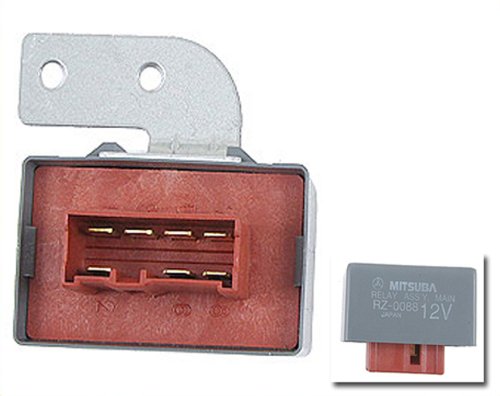

The fuel pump relay (commonly called "main relay" here) is under the dashboard, to the left of the steering column. It's behind the silver cruise control brain box, if you have cruise control in your car.
That's what you're looking for. You can replace it, or if you have skill with soldering electronics, you can open it and resolder the points inside. Someone made a DIY for that, I believe.
