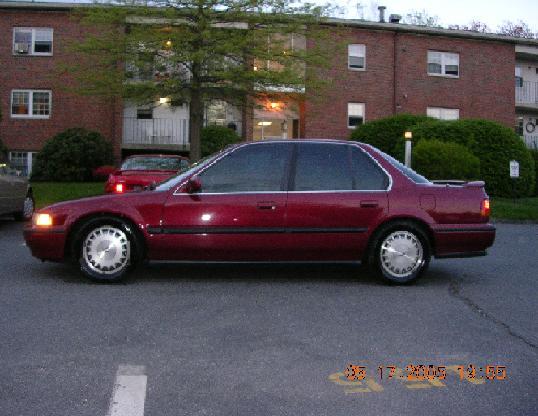

              Is the car in the pic lowered 2.5"? How much clearance is there between the tire and fender? The reason I ask is my wagon looks about that low, same wheels also, and I didn't think it was lowered that much (before I bought it)
