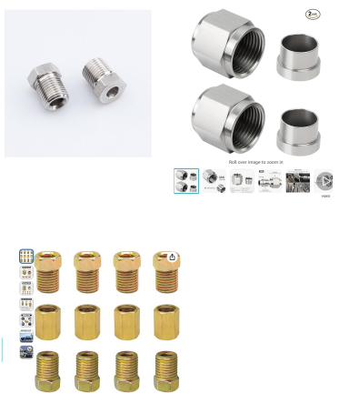

And also the tube nut that fits on each end the size is m10 x 1.0? Is that correct as well?
On each they both need a female and male connector of that tube nut? And they have to be put on before I make the double flare? If I assume correctly?

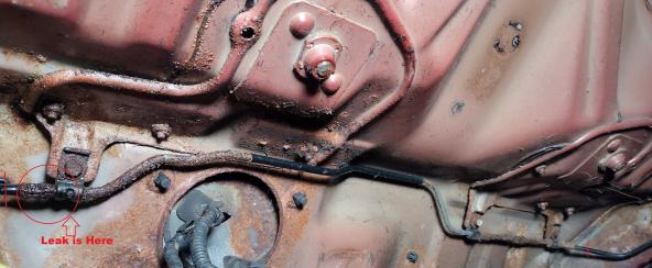

Refer to the picture where the leak is located. I want to know if I can make this simple as possible and just make a straight shot? Because the leak is on the passenger side of the car. But on driver's side I want to replace because eventually it's probably going to leak on that side as well.
I want to make a straight shot between the two red lines. I'm assuming that it wont hit the fuel tank. I'm not sure. If I use those clamps like those 3 that show you, so it doesn't touch it? I'm assuming it will be okay? Or do I have to really make it more complicated than that? And I have to bend it? Has anyone done this brake line above the fuel tank before? Any advice would be appreciated.
