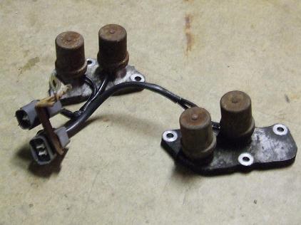

          yer solenoid looks like one of these, right?

            nah mine is not the solenoid to not let me get out of gear. i need the one on the trans that shifts the gears.
              this is what he wants.
                thats it. i need the lower one for the shift control.

                      i took the solenoids off and cleaned it with brake cleaner and let them dry for several hours before reinstalling them. i made sure the little screen on it wasn't clogged with crapola but becareful of that rubber gasket that goes around the bottom side.
                        i just took out the shift solenoid and cleaned it and put it back in a few hours later and now it takes off in what seems as 4th gear. i can floor it and it wont hardly move now. i have to drop it down in 2nd and go.its worse now so im guessing the solenoid is gone. i just purchased a new one off of rockauto.com for $120. wish me luck. could the main relay have something to do with the d4 light and not shifting gears properly? i replaced the tcu and its very rarely takes a while to start, cold or hot weather. it never stalls or cuts off on me and runs like a sewing machine. oh and btw the only cel code im pulling is a "Shift control solenoid valve A"
