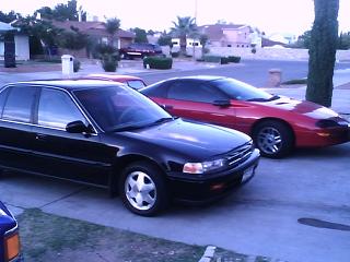

                    thanks for all the feedback, currently i'm getting about 25 MPG, i bought the car this past july and have only been changing the oil, the engine was currently rebuilt so it should be in tip top shape. is there anything special i should know about this specific model? its a 10th anniversary edition 2.2 engine. I'll try and post pics later. CAUTION: it is bone stock
                      my CB7
                      this is my CB7 and my 94 camaro in the background. tell me what you think
                        Wow, nice and clean, for both of them! I'm a CB7 and GM owner myself (02 GTP is my other car).
                        ALL US CB7s were 2.2L. You have the 125hp F22A1 (which can see a bit of a power increase using the ECU and intake manifold from the F22A6... the 92-93 EX motor). The 10th anniversary edition marks the 10th anniversary of the Accord's production in the US. They are all automatic, and they have those nifty 6 spoke alloy wheels that I had to pay for They also have painted side moldings, an uncommon thing.
