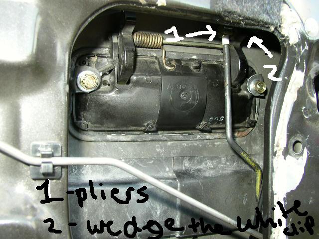

door panel removal
for the door handle slide it towards the hood of the car and then it will move and u should be able to pop it out.
i had teh same prob man it pissed me off...
and the golden thingy inside the handle part u have to like move that white clip thingy around and then pull the golden thing out with pliers thats how i did mineLast edited by TcH2; 03-25-2004, 09:41 PM.92 Accord EX-R

once u removed the 2 bolts for the handle
try and pull the lock clip off and then try and make the lock handle stick out at like 90 degrees and u should be able to pull it my bro help me pull itLast edited by TcH2; 03-25-2004, 09:53 PM.92 Accord EX-R
