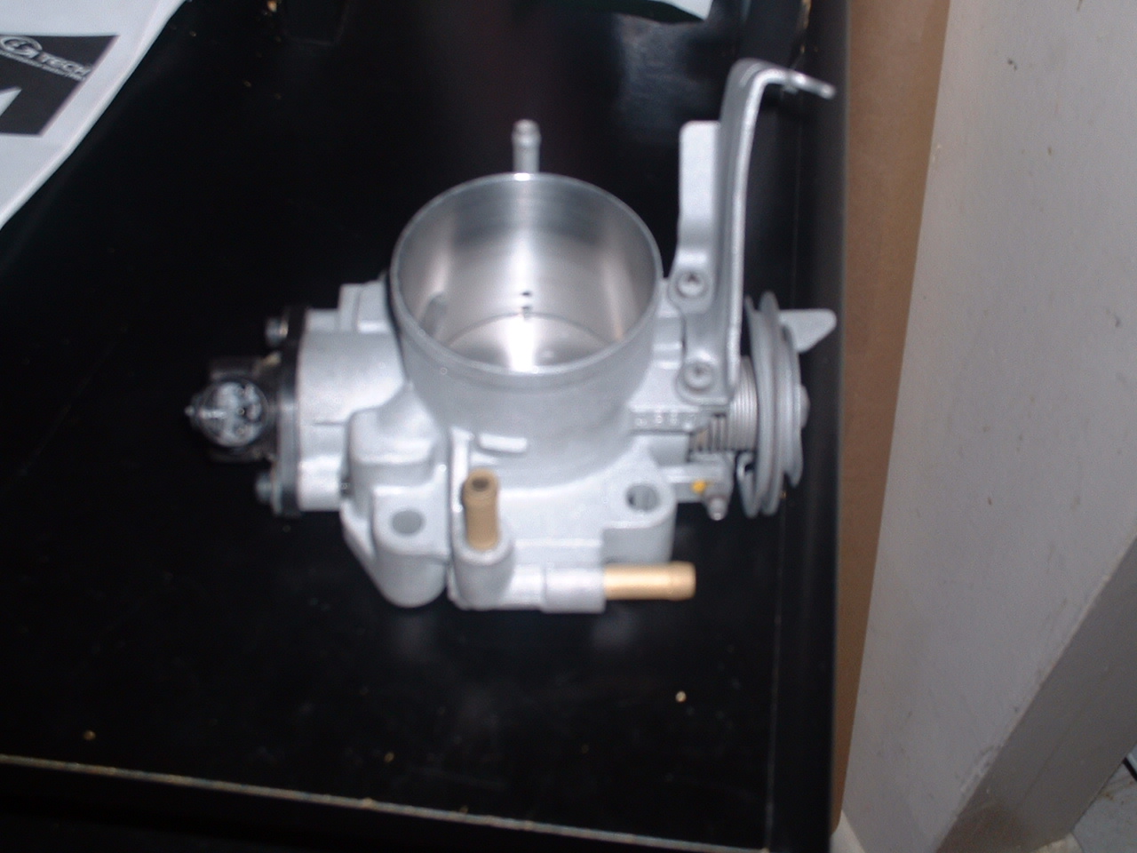

    came in today, put it on a few minutes ago and cars going to the shop tomorrow morning to get head put on....damn im sice!!!
    heres a pic of the Tb...
    jg has a lot of stuff for our cars (f22-and-h22)
    i plan to send a bottom end to them to get work done on it next year sometime, but heres the pic...

    How much did it cost ya, and how long did it take...
    YOu have to send in your TB to get it bore out right??

      yeah, u send a stock TB, make sure u have 2 because i think there not emission legal, but u send it off and it cost 150 plus how much it takes to ship off, like 3-5bux. they ship it back for free. i sent it off and they got it on a monday, they sent it out on a wednesday...took 3 days just about (cause off holiday) to get here
      so it took them 2 days to bore

        so what's the inner diameter of the TB now? stock is like 58mm

          just wondering cuz i got a H23 TB that has 60mm I.D. for $50 w/shipping from junkyard and for another $100 I got a H23 intake manifold , have the F22a6 lower half. For another $75 I can have the intake manifold ported. Of course this would all benefit even better with cylinder headwork.
          If ur going larger TB, there is no point unless u open up the whole intake system right? don't want any bottlenecks or it's pointless..

            I'd like to see some dyno figures on this part. I wouldn't be as worried about bottlenecks as I would be about sacrificing intake air velocity and the subsequent loss of low and mid-range torque. Not to imply that this particular throttle is overly large, it may very well be sized perfectly to increase flow with a minimal velocity decrease, but it is not uncommon to see an overly large throttle body bore on a given engine (a 70 mil throttle body on a stock B18b for example).

                    I have the same TB... any tq loss was almost non existant and unnoticeable. The mid/upper rpm gains are by far worth it and very noticeable...When I installed it I only had the full slew of bolt-ons and not the delta cam but it did seem to be a bottleneck even w/ the stock cam...
                    I still have my old stock TB... I should put it on and see if there's any difference...
                    and anyone who puts a 70mm TB on a stock B18 is just plain retarded...

                      yeah, i had the same set up before i blew my head (which was p&p street/strip by gude) plus other mods but i didnt have the TB
                      now i have a mild p&p job on my head and the tb (with other mods i had) and my cars way faster then it was at first.
                      the throttle response is nice, nolonger drags thru rmp. i shift and it goes................
                      trust me, its a noticable gain
                      i have a g-tech meter and my 0-60mph time used to be in the 10's
                      now i run a best at 7.7, average 8's
                      and i think it has a lot to do with the TB.
                      if the TB u haves not stock and is bigger, u will notice a nice gain/difference
