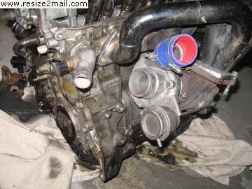

here's a pic of my manifold "bolted" up. i was wondering if this would clear my front engine mount.
Front motor mount
i believe you can swap the lude front crossmember into the car, to get the low, unobtrusive front mount, which looks like it would fit, if the stock one doesnt... if you absolutely need the front mount, its an option that you might want to research... didnt Accord SiR do this?
