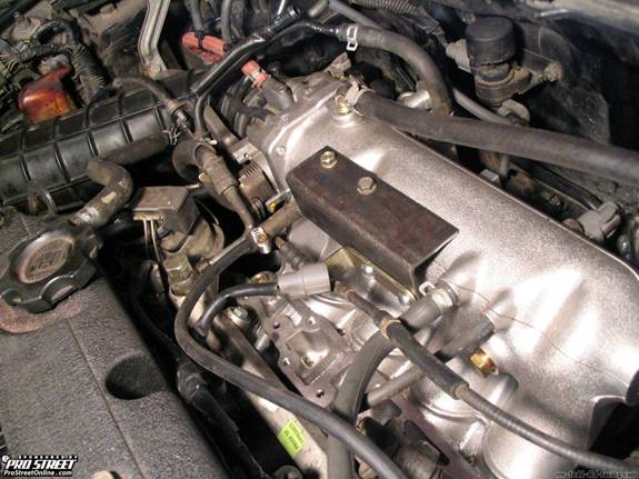

Ive never ran with the stock manifold or the Skunk2, but im happy with my Euro R manifold. It does require alot of work to get it fitting, but its nothign too difficult. We used some t brackets for the vacuum lines, had to drill a hole for the MAP sensor, and make a bracket for the throttle cable and fuel rail. We also had to bend the fuel line slightly to clear the EGR valve, block off some ports, including the EGR ports in the runners.
(yeah, i know the coolant lines are ghettoed right now, I had to throw it together quickly)
