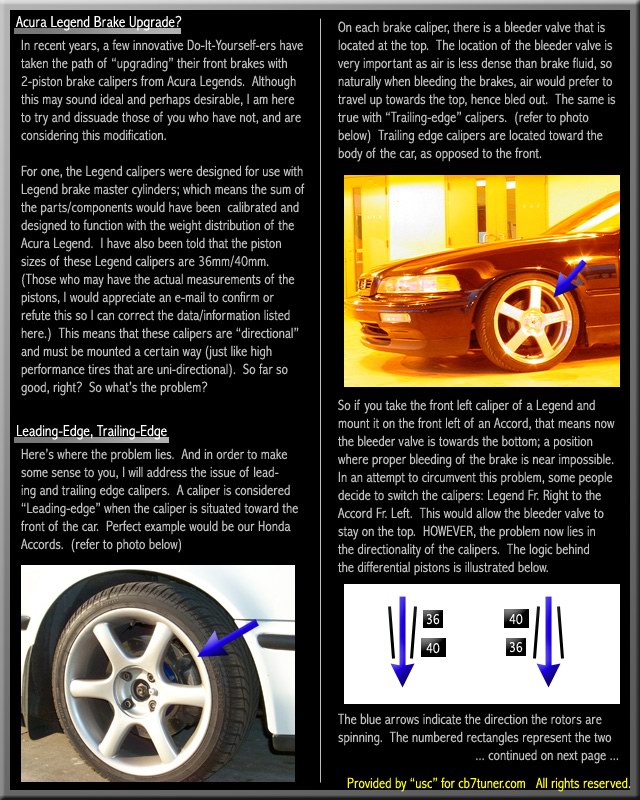

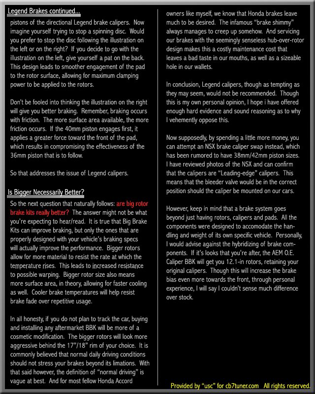

see attached image:
Legend Brake Swaps... things you ought to know.

what if i were to have mounted them on the correct sides, left on left, and right on right. Lets say that problem of bleeding was taken care off before they were mounted on the spindle itself using a 2x4. and holding it upside down. Would you consider this a relevent solution to that problem? Even though that still leaves us with the proportioning valve and M.C?? Give me some input. Thanks.
Phil
sure. if you can properly bleed the legend calipers before mounting them, then in theory, it should be safe(r) (than mounting them backwards). you'll just have to always remove the calipers and bleed them that way from then on.
should also consider whether or not you're planning to keep the car forever. might make the car more difficult to sell later with this setup, unless you swap it back to stock calipers.Once upon a time I took a joyride in a Huayra...
Fizzbob... What you want is the acura CL 2.3 swap. Go to www.accordinglydone.com go into teh stop drop and roll forum, and read the sticky about rotor over hub conversion complete. Its the same size as stock, just rotor over hub.
There are many valid points in this article, but I would just like to add some things. The European 6th gen Accord Type-Rs use Legend Calipers which are mounted in the front of the knuckle. Honda flips the Legend caliper from the factory. It may not be as efficient as having them on the trailing edge, but IMO the clamping power between the 2 setups may not differ significantly(speculation), therefore I guess Honda deemed that it was safe enough to put Legend calipers backwards on Accord Type-Rs for the European market.
Note: I have compared UKDM Type-R calipers with USDM Legend calipers and they are identical.
this is something that's difficult for me to accept unless i see pictures of both side-by-side, and to know it is genuine Honda Type-R calipers. reason being i can't imagine Honda would have a car in production having the bleeder valve on the bottom of the caliper, making it extremely difficult to bleed properly. that is a liability issue that no manufacturer would (or should) be stupid enough to place upon itself. that's just a freebie lawsuit waiting to happen.Originally posted by OEMaccord
i'm not trying to ruffle feathers, it just doesn't make sense and at least for *me*, i need to see proof: pictures, part numbers, etc... before believing it.Once upon a time I took a joyride in a Huayra...
okay, then my next question, which you vaguely alluded to but as i'm seeking confirmation is:
i assume the ATR caliper is also dual-piston. now what sizes are the pistons? if the pistons are different sizes, then in reference to that photo you posted, is the smaller piston on top?Once upon a time I took a joyride in a Huayra...
