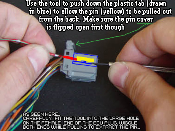

Where to get pins:
Go to a junkyard, find any OBD-1 Honda, and cut the ECU harness out. There you have a ready supply of ECU pins. Just remove the style pin you need and install it in the blank spot on your current plug. Of course cut enough so you can splice to

Where to get pins:
