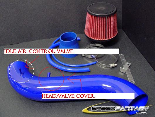

                            the refered pop is a valcumn issue...i fabricated my intake on my car and when i did so there wasnt a spot for the line that runs from the right side of the intake manifold so i put a breather on it...it ran fine..then one day i decided to run that line to one of the unused ports on the throttle body so i did..when i did this a gave it gas this resulted in the before mentioned popping sound....try to unplug that line if you ran it to the throttle body and push a small 2 1/4 inch breather over that diaphram..its what the line that runs across the intake runs too....and goldish in color...cant remember what its called sorry....thats why accord made intakes have two ports...the one that goes to the head an the smaller one that runs too the other side of the manifold

                              Yeah, I don't think it's a backfire through the intake. It's some sort of vacuum leak or improper installation.
