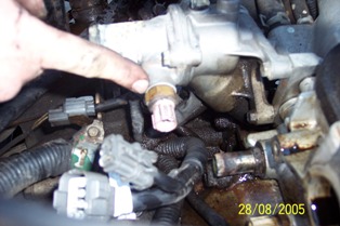

Did you try bridging the Thermo Fan Switch Connector (White/Green & Black) Terminals (Switch Located at Lower Radiator Hose Thermostat Outlet?Originally posted by 91accordwagonFans function when jumped. ...Coolant Temp Sensors are recieving voltage and are within resistance spec during warm idle.
The Radiator Thermo Fan will only cut in at High Coolant Temperatures
