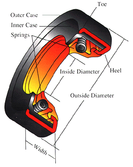

      I'd say the reason the Mechanic said it was the seal would be because when the Inner CV Joint Popped out of the Trans-axle it may have damaged Axle Seal. Even refitting the CV Joint all the way with a new clip may still cause the Seal to Leak. Oil Seals have a round spring on the inner side of the seal lip to force it out and keep the lip sealed against the shaft. If this spring has come out then the seal lip may not be seating right. I'd also check the end of the Spline and make sure the circlip land hasn't broken off.
