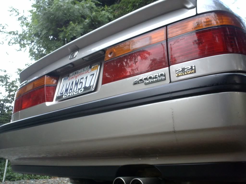

Engine:Car Started Automatic And Was Converted To Manual.
Today
JDM Automatic H22A 65K Miles (180hp)
New Seals, Timing belt, Auto Tensioner, Deleted Countershaft Belt, All New Gaskets, New Coil, New Spark Plug Wires, All New Belts, Retained A/C and P/S, ESP Poly Mounts "Auto To 5-Speed Mount Kit".
ECU Is CA Emissions P13, Engine Is Now BAR Certified And Smog Legal
Transmission:
T2T4 LSD Short Ratio Transmission. 44K Miles
Aluminum Fidanzda Flywheel With New Clutch and Pressure Plate
New Clutch And Slave Cylinders With Steel Braided Clutch Hose. Dot 4 Fluid
New CV Axles.
Exterior:
MDM Chrome Trimmed 1-Piece Headlights, 6000K HID's In Headlights, Custom Ground 90-91 Grille (to match headlights), New foglight kit, JDM Lenses On Foglights, 3000K HID's In Foglights, Legend Coupe Lip, 5% Tint For Back Windows And Windshield Bar, 15% For Front. Various New Stainless Trim, Factory OEM Flushmount Spoiler, Accord Coupe 2.2i Exclusive Badging, CD5 Rear Lower Sidemarkers.
Interior:
1992 Accord SIR OEM Amber Dash components, BB6 Intrument Cluster, 92-93 Style Dash Panel, 94-97 Accord Steering Column With AP1 S2000 Steering Wheel, CTR Shift Boot/ITR Shift Knob, EX Glove Box Light, OEM 90-91 Armrest, New Rear Speaker Pods.
Suspension/Wheels:
92-96 Prelude Si Rims, ABS Brake Booster And Brake Master Cylinder Retrofitted With Dot 4 Fluid, 91 SE Rear Discs, Integra 40/40 Proportional Valve, Vigor Rear Sway Bar, All New Boots.
Audio/Electronics:
Pioneer Avic-N1 Flip Screen/Touch Screen DVD/Navigation Stereo with Pioneer Speakers All Around, 1x10" Pioneer Premier 1500W SPL Sub With TWO 800W Mono Block Amps, Pioneer Ipod Adapter.
