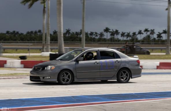

2006 Corolla XRS
Non sunroof, 1e3 phantom gray pearl.
Built 2zz-ge; Mahle 12.3 pistons, bc rods, acl rod and main bearings, arp main and head studs, Morosson 6qt baffled pan.
Supertech flat valves, crower springs and retainers, ferrea keepers, piper stage 2 cams. 9k rpm redline.
71mm throttle body, r9k intake plenum, ported intake runners.
PPE 4-1 headers, 2.5 piping to a Borla pro xs muffler.
630cc siemens injectors, aem 320e pump, flex fuel sensor.
haltech e1500.
Built trans, Trd LSD, billet SSC 3/4th gears.
Coilovers, poly bushins all around, ultra racing bars all around car, custom billet hand made shifter from Canary Islands, RZR.
203whp, unfinished pump tune. Uknown whp with e85 yet.
