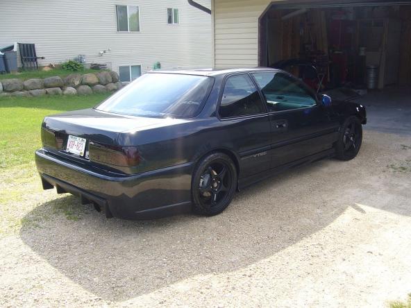

                  I blacked out my stainless last winter when I repainted my cb. I cleaned all the stainless up real good with a wax and grease remover, scuffed it with a red scotchbrite, primed it, sanded it smooth, sprayed it matte black, and clear coated it with PPG's Soft Touch clearcoat. It's a two part clear that dries flat and feels like rubber. It's pretty cool stuff and will protect the color from UV rays and solvents.

                    nice work WHERM on your trim.looks good. good ideals guy keep them coming.
                      Thats a clean ride man
                        The only advantage to using vinyl (other than being able to remove it) is that it may be more resistant to flying debris "removing" it. I actually used bumper coating (satin black) on mine and after 1000 miles and even some rain/snow it's still on there.
                          The black trim looks way better, imo. I don't know if I'd want to use vinyl though. I just painted mine flat black.
