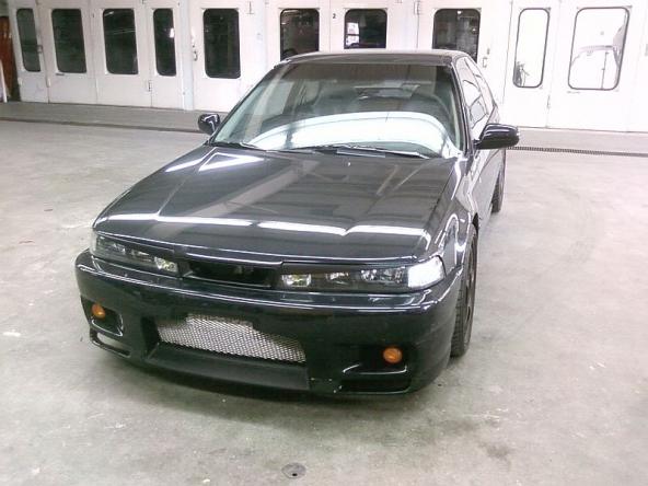

I drive a 93 lx coupe, all sorts of mods, the latest being the eyelids and grill shown in the pic below. I'm an active member on accordinglydone.com, build thread: http://www.accordinglydone.com/forum...ad.php?t=15343Last edited by wherm; 12-06-2008, 01:01 AM.
